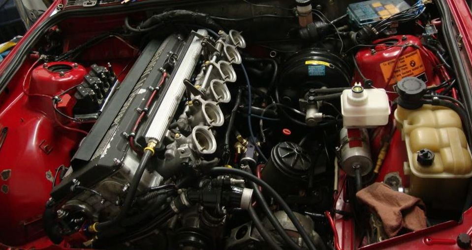

              go to E30.de click on the main pic of cabrio,
              I think A V8 BMW is the way to go powerful and smooth.
