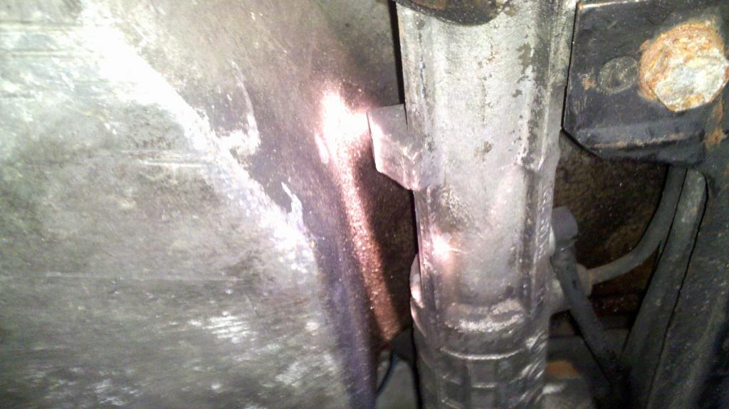

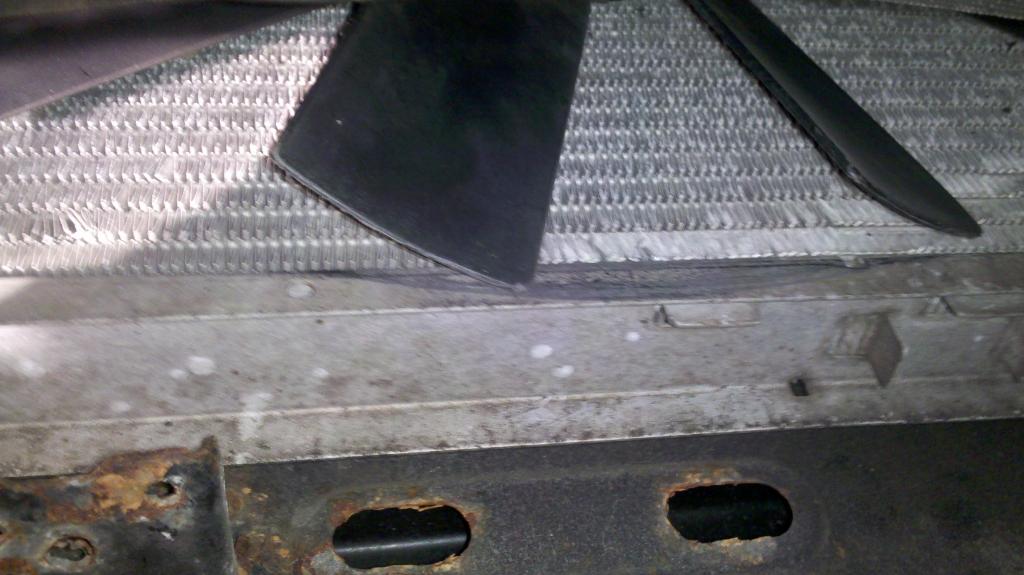

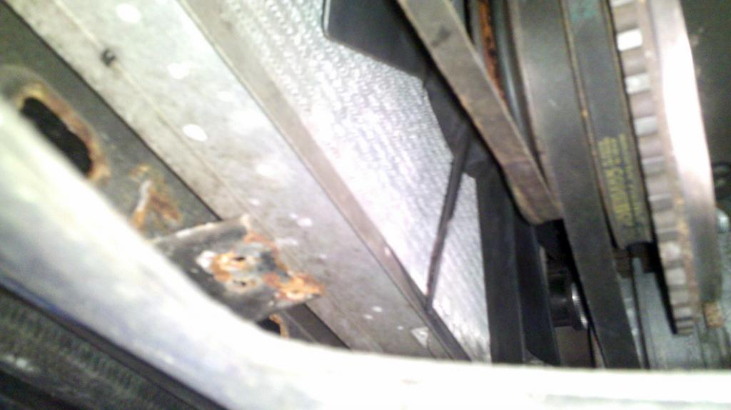

        Heres a pic of how close my fan is to the radiator. I also took a pic of the distance between the rack and oil pan (e36 rack). Its about 7/8". I dont know if my motor is too far foward or what, but my shifter does seem to be sitting a little bit foward in the console, and I think my radiator mounting is all legit.
          Fan is leaving a black mark by rubbing on your radiator.
            I think your motor might be shifted a bit forward. When I changed my fan clutch it didn't come that close to hitting the radiator.
              Are you sure the radiator is right; is the clearance between the radiator and the fan consistent from the top to the bottom?
                I have the exact same problem as bimmer630. I have new motor and trans mounts installed, but am having a clearance issue with the fan and radiator. Mine rubs the bottom the same way as in the pics. I thought my radiator was seated correctly, but I'll have to double check when I do some cooling work soon.

                    Fan rubbed into the radiator tonight and put a hole in it

                        There is a small rubber buffer under the motor part no RUBBER BUFFER 11811132527
                        from RealOem. I have mine replaced recently. probably you need to check it
                          Yeah after replacing the radiator, I played around with the mounts. That little buffer that keeps the drivetrain from pushing into the subframe is missing on my car. the bracket is there but no rubber.
                          I was able to loosen up the trans mount "sliders", pry the engine back and tighten the trans mounts. all looks ok now.
