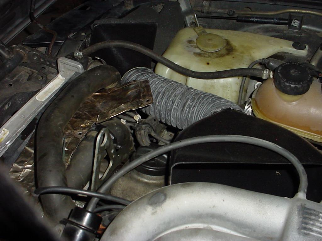

Help identify these two hoses off throttle body?
    Well I have a small hose (the WHITE arrow) but cant find where the other end goes any help would be appreciated...
    Found the larger hose (Red Arrow) Breather hose, next question... Can I put one of those small filters on the valve cover now and plug the throttle body port till my hose arrives next week?

              Any help with the smaller outlet, white arrow! Please!
                Anything, just a little confirmation would be nice
                  They are coolant lines to the throtle body many ppl just bypass them.
                    cold coolant- cools down incoming air. thus giving more power to the car
                        I don't have that TB but my white nipple appears to go to the charcol canister below the TB next to the fuel pump. There is a small line going to the white thing and a fuel line on the canister. This is how you kool a manifold and TB for power, the other duct goes to the ETA oil filter, full CIA on drivers side
