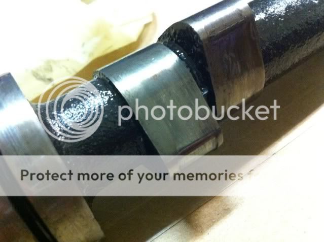

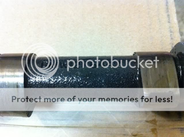

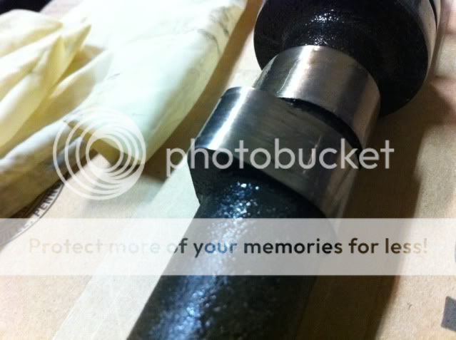

                              Took the Head Part Today :( This head came off a Friends 325i with a 2.5L Engine. When I was taking it apart. I noticed that it has only 4 Cam Bearings and 4 Oil Passage on the 885 Head. Which is Totally Weird. Also it has a Cam Number BMW1266447. I am looking for a new cam as the pics below will show why. :( From investigating. Seems like the Valve Adj. and Rods was done/installed incorrectly.
