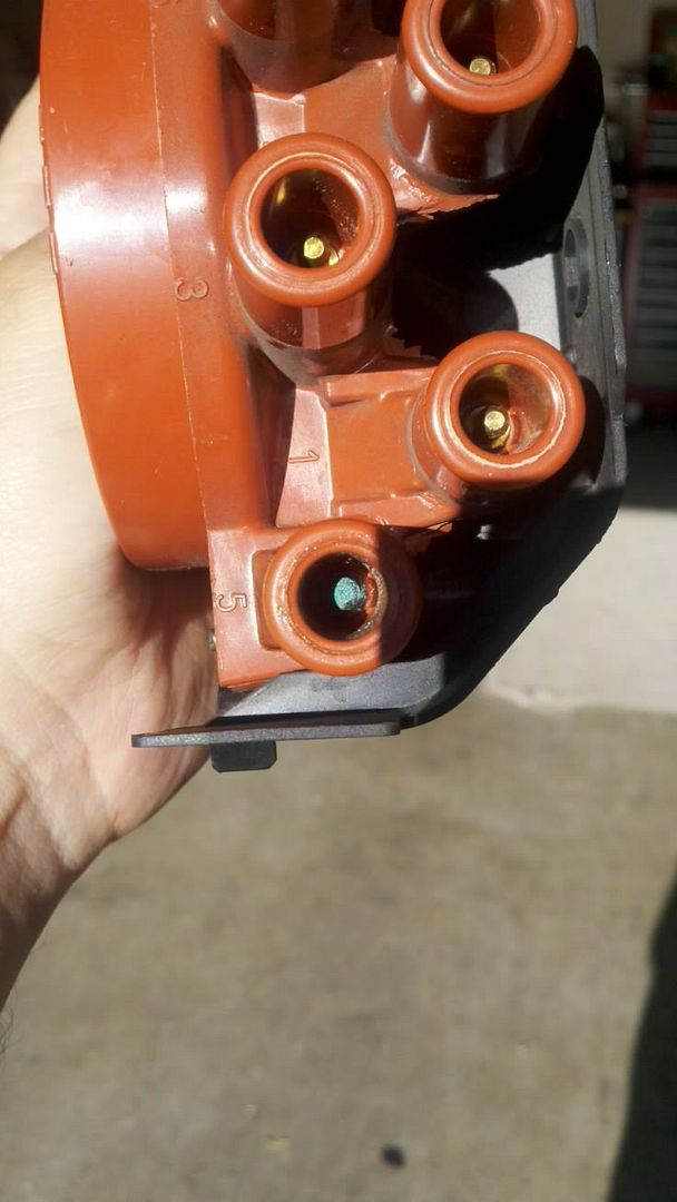

                            Well I think I've solved it but you wont believe it...
                            Here is a picture of my distributor cap
                            See #5 down there??
                            Hmm so its wet but how is it mysteriously causing intermittent problems??
                            Ok so the small hose coming from the radiator to the expansion tank had a tiny leak at the tank side. The tank slightly leans at an angle. The spark plug loom broke free from the valve cover and was upright. The leaking coolant was running down the bottle onto the loom then inside and along the wires where it traveled down #5 right between the boot and wire. It was so minor that I didn't see it until looking at the underside of the wire where there are deposits from the antifreeze baked onto it.
                            I rigged the loom up proper until o can replace it, changed the small hose, and zip tied the boot to put tension on it against the wire so the fluid can't get in.
                            We'll see how it goes lol
