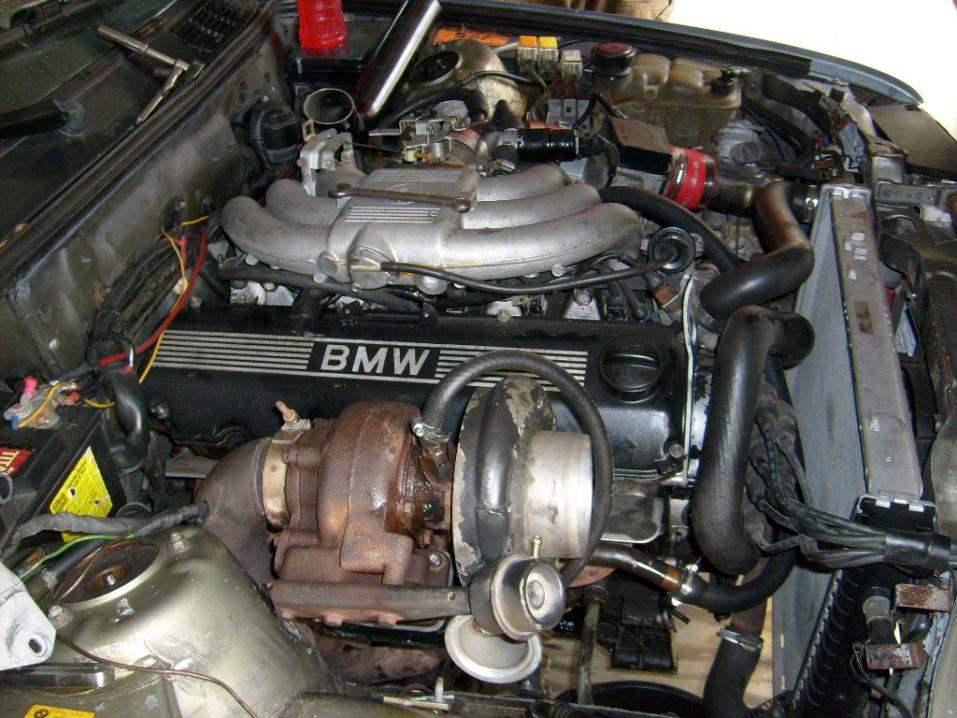

    i turbo charged a stock m20b25 engine, i have it set at 5 pounds of boost, i only have 19lb injectors, here is my issue
    when i shift from 1 gear to another the whole thing cuts out for a short second? any ideas? im thinking i need more fuel but i just if there where anyideas???
    and here are some pics of the set up

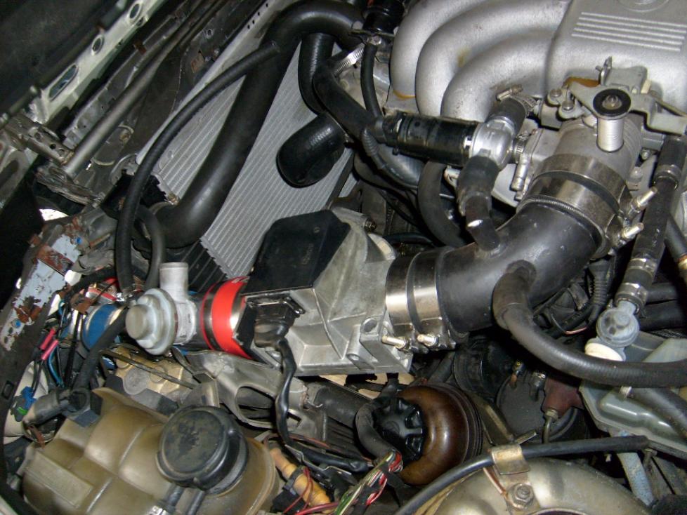

                That sounds like it could be a blow off valve problem.

                      When you execute a shift the engine has to drop from high rpm to a lower rpm. The turbo will be spooled up from high rpm running and will be delivering more air than the engine can use when it drops to lower rpm. The blow off valve should should relieve that excess pressure. If it doesn't, the engine will momentarily be running too lean.

                              5 pounds off boost shouldn't be a bov problem, really? It could be a fuel problem, take out a spark plug and see if ur running lean.
