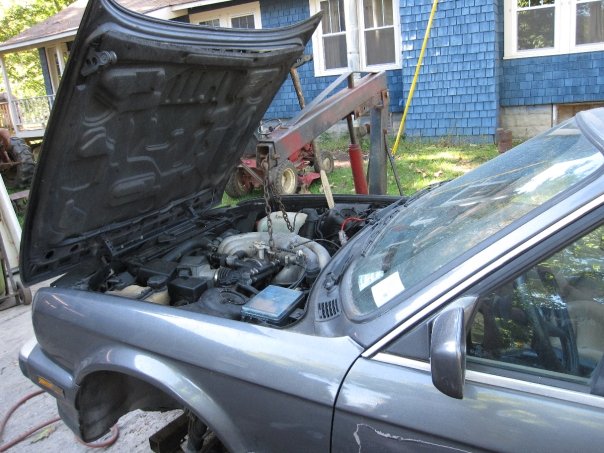

                    • F34R
                      sLaughter
                      • 12385
                      Originally posted by jlevie
                      I'd use an engine brace over a hoist. You don't have to remove the hood and feet of the hoist won't be in the way. If I change the pan with the engine in the car I support and lift the engine with an engine brace and drop the subframe as far as it will go with the steering coupler disconnected.
                      (My picture)
                      I left the hood on and the removed the mounts, then I let the subframe hang from the suspension. Then I just extend the hoists arm from the passenger side fender. It is a little tricky getting the steering sleeve back on. What I did was unbolt that and slide it out 3" bolted the subframe back on and then install the rack WHILE sliding the steering coupler back and tapping with a hammer on the rack.
                      Instagram: @BWeissLeather
                      Current cars:
                      ~ '87 325 M30B35 swap
                      ~ '87 535
                      ~ 01 540 Msport 6spd
                      ~ '06 X5 4.8is

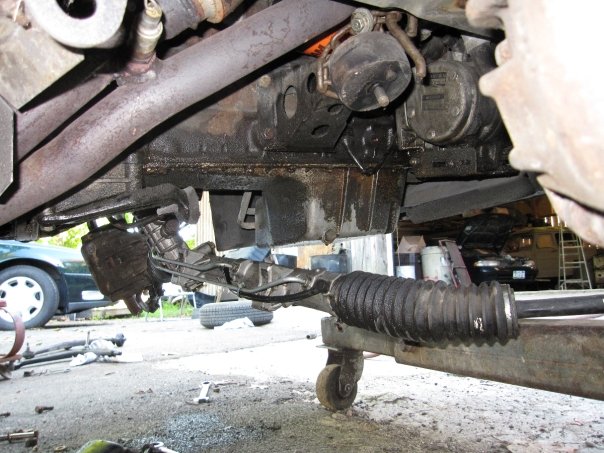

                      • F34R
                        sLaughter
                        • 12385
                        Pay no mind to the messy engine, that is out and being turned into a 2.8 stroker with more goodies than a 2k hooker.
                        Granted I took the subframe out because I had to do the control arms and eyeball bushings. But you can see how I left the rack hanging in place to keep alinement. You can see how I used the engine mount arms for the hoist chains.
                        Current cars:
                        ~ '87 535
                        ~ '06 X5 4.8is
