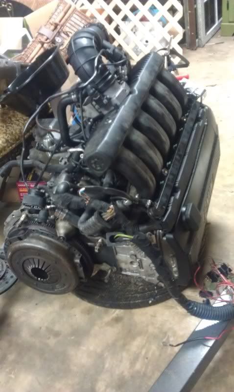

                  • mitchlevy7
                    • Aug 2011
                    • 672
                    hahha. i never did that^
                    i picked this up instead. the whole swap, including a 5 speed swap, an engine hoist, and a bunch of tools was about 2k.
