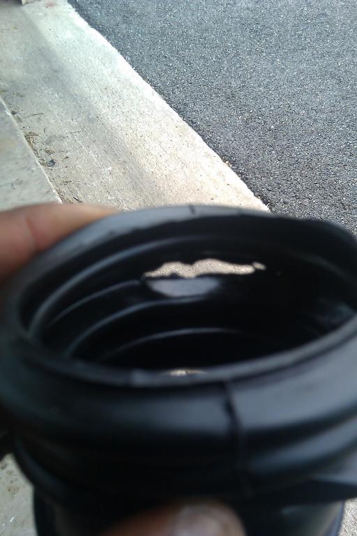

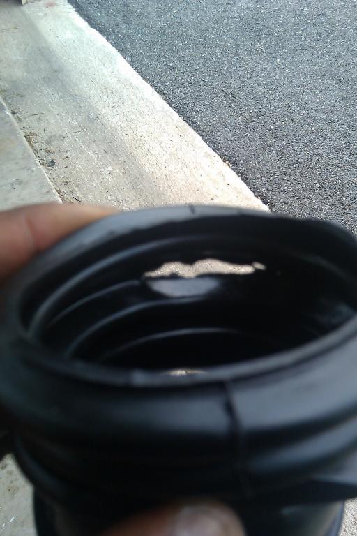

        about a month ago i went to start my car and I had some crazy rpm's like that also. it turned out my intake boot had a slight tear in the bottom. so check the anything before the throttle body. your intake boot gets hot under the hood and may have ripped. mine ripped cause its chillin off the bracket i think. i need that miller maf ASAP.lol
Name:	ripped intake boot.jpg

          MMm that definitely could be my problem...But yesterday it happens to me and I hit the ICV and stop doing it... but today is other story it just run normal, i need to run a deep inspection, Thanks a lot for the info!
