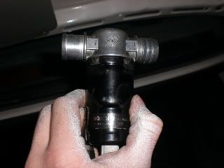

am I missing my ICV?
  • bastianshaw
    • Jan 2007
    • 2210
    Im thinking its totally missing?
    89 325is
  • MrSlacker
    • 2494
    No you are not. This is how it looks like

      Yes

          Look right next to the dip stick. It's the L shaped one with the plug in the back.

            there are no hose clamps...it just slides back on?

              You ARE missing hose clamps

                you shouldn't need hose clamps for the icv

                  that first picture is basically a picture of the IAC/ICV

                    ok so off it came and I sprayed hella brake cleaner in there, but no noticeable difference, my car has always had a lumpy idle could this be why?

                      you dont need hole clamps on it. and i did clean my ICV also, didnt make a difference on my crappy idle and i have a brand-new hoses.

                        have you tried un plugging it on a cold start? im thinking if there is no difference that the unit is shot

                          If you unplug it, the idle should jump up to ~1500 and then fluctuate between ~500 and ~1500. If it doesn't, the idle control valve is probably shot.

                            yes, i get a worse idle when i unplug mine.

                              lumpy idle - check for vacuum leaks and be sure all your cylinders are firing.
