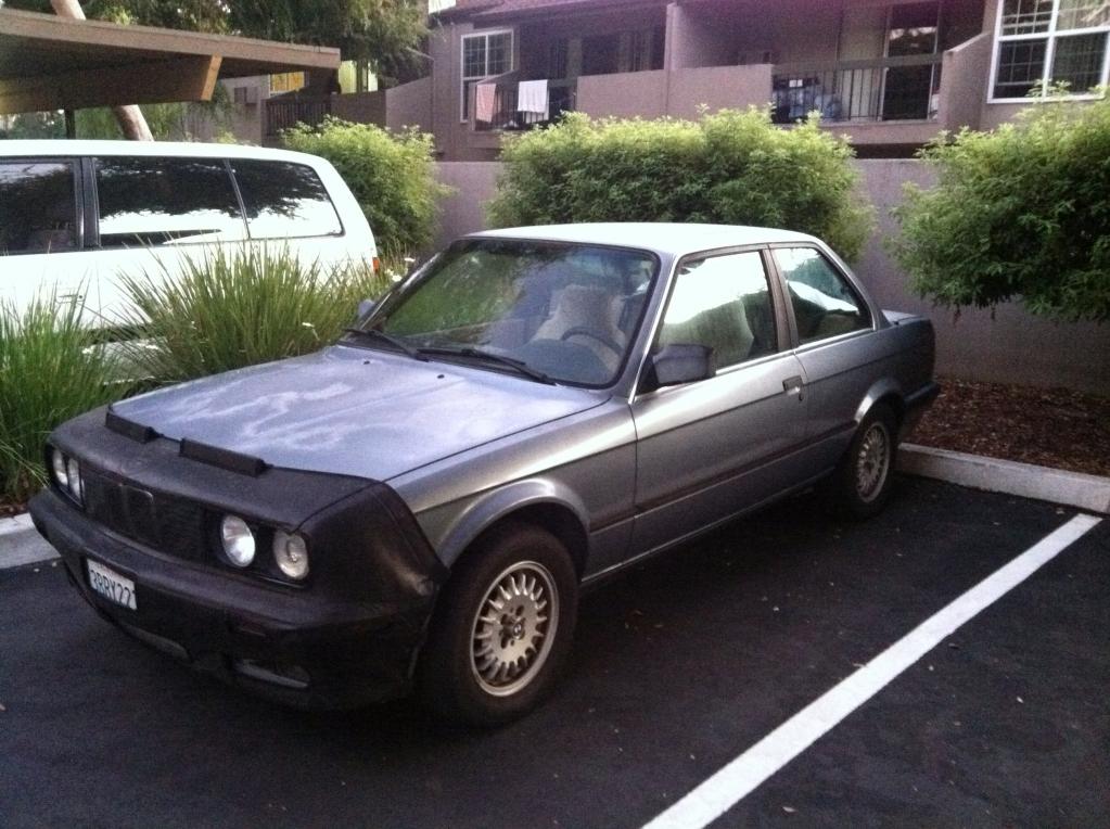

    Hello guys, im new to e30's, and i just bought my first one. The guy i bought it from had not driven it in over 4 years, so my question is, what should i replace so that my engine will run good again? Also my car makes a really loud ticking noise that sounds to me like the injectors, but im pretty sure the car is over due for a valve adjustment. The car idles kind of rough and when i rev it, it takes a while for the rpm to come back to idle again.
    Any suggestions are much appreciated!!!
    Sorry for my shitty thread, this my first post on any forum....

    Adjust the valves pronto. Change the timing belt,water pump and fluids while you are at it. Welcome to r3v.

      Not a bad start! Take that silly bra off.. its like having a muzzle over your dog.
      Like Keith stated, you want to do some maintenance.
      Replace all V-belts
      Replace Timing belt & Tensioner
      Replace waterpump & gasket
      OBVIOUSLY new coolant
      Replace engine Oil and Filter
      Replace engine Air Filter
      Replace Fuel Filter
      Replace Spark Plugs
      inspect condition of the bushings of all suspension components. - Replace anything thats cracked, worn, or blown.
      Inspect & Test all fuses -> replace if necessary
      Let us know if you fall into any problems! And first purchase for this vehicle should be a BENTLEY manual! Get one, and keep it close... most of the time mine is in my trunk.. But its at home right now.

            I agree with the above, EXCEPT I would put changing the timing belt as #1 priority unless you have verifiable records of when it was last changed.
            If you don't think it's important, just look around at the "my timing belt broke" threads and see what I mean. If the belt breaks, you're in for a $$$$ repair (if you pay someone to do it) or a fairly big and expensive job even if you can do it yourself- but it can be prevented by changing the damn belt!!!!1

                  I can do my own work, I'm an entry level tech at Nissan. Bmw's are whole new thing to me though, so I feel lost. Are there any good timing belt kits you guys would recommend out there?
                  Also I noticed that when I was driving home on the freeway everything was good, but once I started driving on the street the car's temperature was getting a little hot according to the gauge. What should u check for? And is it worth going with an electric fan?

                    Do as stated above.
                    I buy the vast majority of my parts from autohausaz.com because they're cheap, the part quality is good, shipping is free, and they're fast.
                    Check the fan clutch for your temp problem around town. Use the newspaper test.
                    If it is bad, then replace it. You can get one from rockauto.com for $35. You'll need to remove it when you do the timing belt anyway.

                    Since it sat for 4 years, do the belt immediately. Also check brakes and brake hoses, play in driveshaft, suspension bushings, and anything else you can think of while you're at it.
