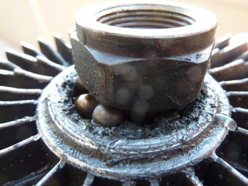

        • funcrew
          • Jun 2007
          • 1223
          +1 on the fan clutch. When the bearings fail and seize up, it throws the fan off-center, which can run it into your shroud.
