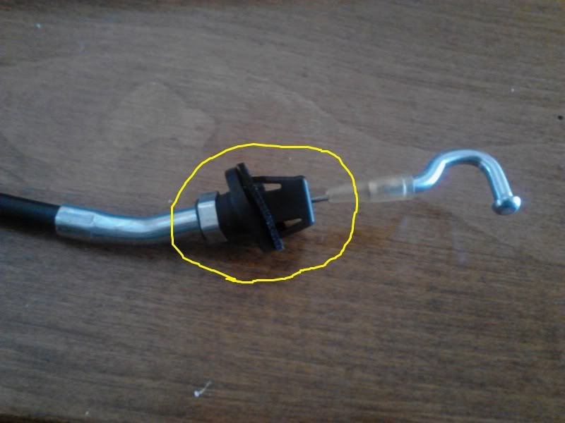

                I've been reading DIY's on this and they keep mentioning some plastic clip that they have to break to get the old cable out, is it this thing:
                • E30Gus
                  • Jun 2008
                  • 781
                  Some times the cable will frey inside the sheathing and cause it to be hard to press. Replace it with a new one and you'll be golden.
                  Shouldn't have to break anything to replace the cablel; its pretty straight forward.

                        Real OEM says:
                        Part #14 Accelerator Bowden Cable
                        p/n: 35411154285
                        $29.59
                        • paperplane94
                          • Jul 2011
                          • 420
                          You probably also want to get new #7's (2) listed in the photo above^
                          p/n: 35411119016
                          • AT-JeffT
                            • 145
                            It will probably take you a 1/2 hr your first time replacing the cable.
                            I replaced #7 on my e30 after seeing one of mine was missing, and it made little difference. I replaced the cable and it was smooth as could be. Replace the cable and never look back.
                            Fap99.com and Autohausaz.com both have the cable under $$20.
                            • AlexMac
                              • Nov 2011
                              • 159
                              OK looks good. The only problem I can see looking at it is that my number 17 is seized to my cable. Ill probably just replace those parts as well. Thanks for the help guys!
