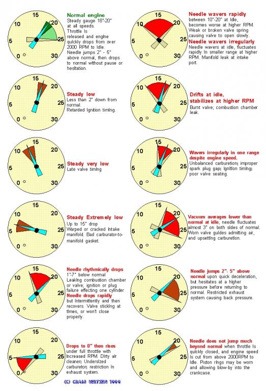

                While on the subject of vacuum gauges, what are the chances that a gauge like this would give me any kind of useful results?
                Any reason these cheap gauges say they are for carbureted engines? Isn't a vacuum a vacuum? Seems like anything that'll read 0-25 in/Hg will work just fine for the M20.
                (FYI: Bentley says normal is 15-22)
