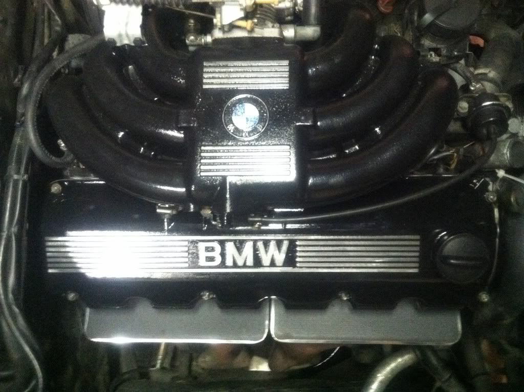

                Here's a pic:

                  Are you saying that the CEL doesn't come on when the ignition is switched on? If so see above for possible causes.
