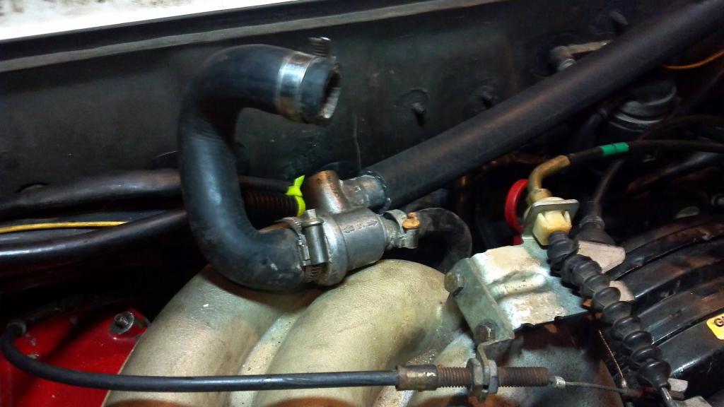

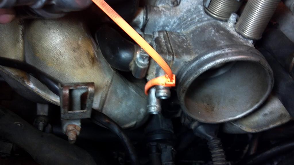

    I got all of the electrical plugs and wires filled out but i have couldnt figure out what would two hoses are supposed to fit in the side of the intake. I have a picture attached of these two valves that i speak off
    i am also confused about what to do with the heater core hose that is at the rear of the engine leaving the head. all i have is a strange valve thing that has one hose missing. i have a picture of this contraption attached

    Bypass the throttle body heater lines. Splice together the line coming from the thermostat to the one coming from the end of the block
