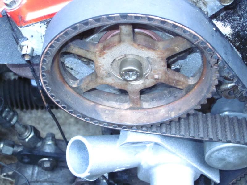

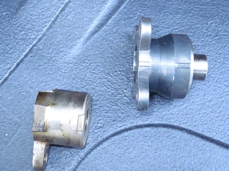

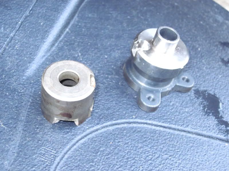

    It's the part that the disty rotor bolts on to, with the three arms. The previous owner of my car tightened the rotor so tight he stripped the three little allen bolts and seized them in their threads.
    So I ran part numbers, confirmed iwth realoem for the build dead and the dealership. I had to get it shipped from Germany, and the part I got isnt like mine, and I can't find mine on realoem. And the dealership is closed today.
    Here are pictures. You can see "gimpy" the old one, and "Wrong but new" one.
    Where it goes:
    Comparison:
    Anything I can get would be great, thanks

    If it were me, I would post a WTB thread on here for a cam gear WITH that rotor flange already installed. Get yourself the later style i gear and flange.
    What part number is the part you got? I show 11311287625 althought I'd still try to return it and go with my plan above.

      From what I can see on Real oem, 11311287625 is the correct part #

          I found it, it's part number 11311713064. Realoem does have it, but doesnt show it. They have a duplicate entry there....
