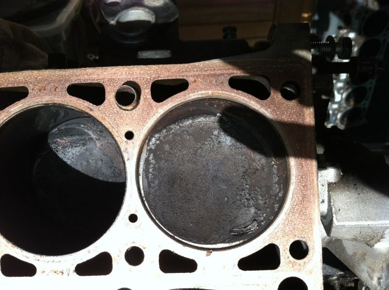

                  I have managed to take the motor apart. Looks like the issue is in cylinder 1.

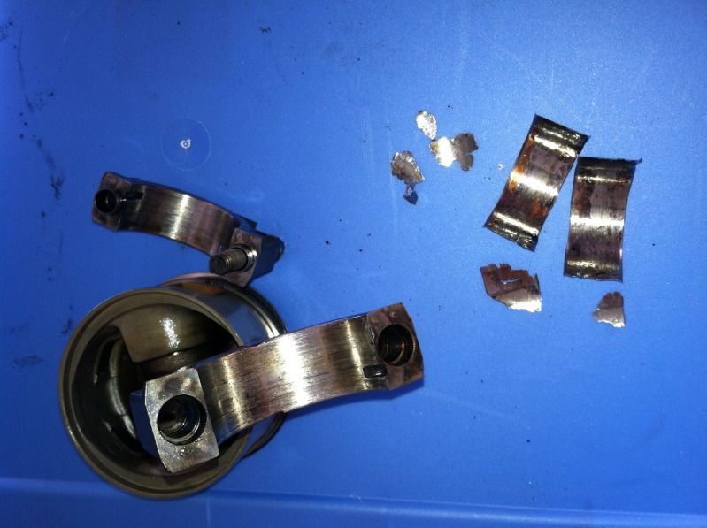

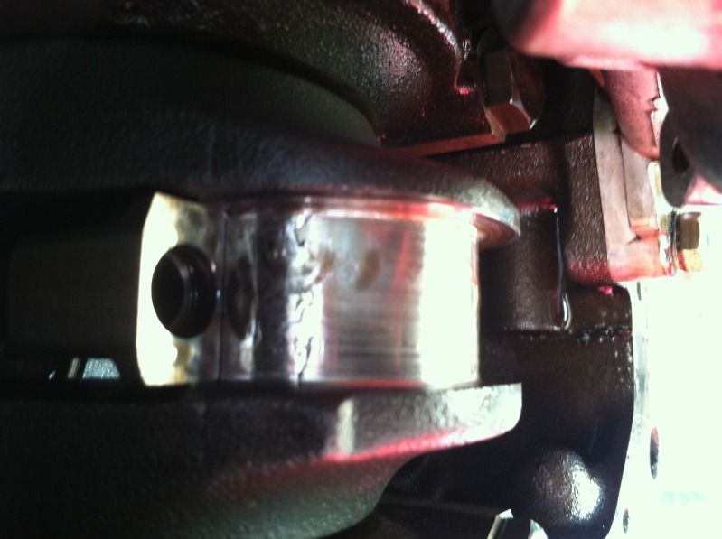

                  Spun bearing. The oil pan is loaded with shiny bits of bearing. I need to mic the crank does anyone have specs of the rod and main Also The piston was slapping the head. Is this going to be a huge issue. Should I be looking for a new rotating asembly
                    The specs for the crank journals are in the Bentley. Take the crank to a machine shop and have them check it unless you have 10th reading micrometers. The piston was kissing the head, but unless that resulted in upset of the metal it will be okay. Measuring the top diameter of the piston at several points will tell if there was upset.

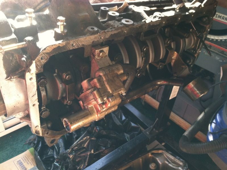

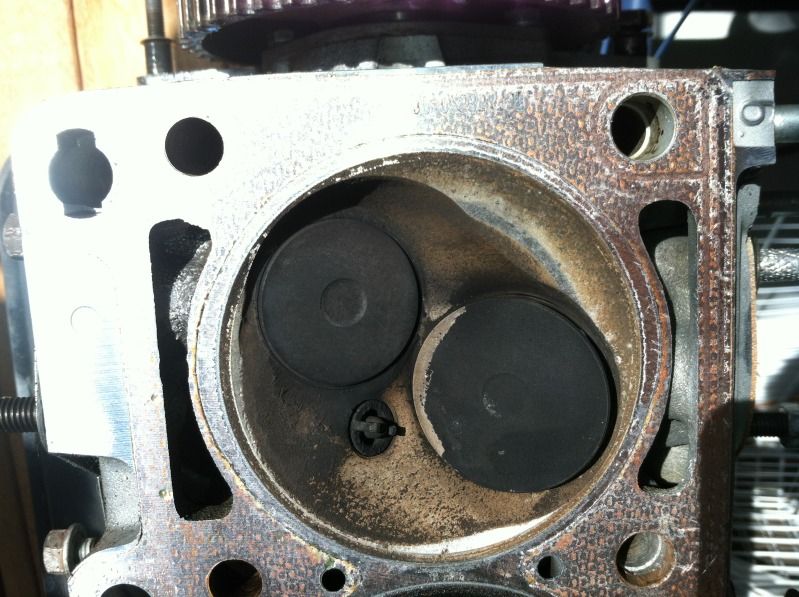

                        Same thing on cyl 2 rod journal. 345&6 are worn thru the silver layer of bearing to the copper color center of the bearings. It looks like I should disassemble the freshend head to clean out all the oil. I do not want to waste the new valve guides. My guess is the oil pump is dying
                          or the crank is out of spec
                            anyone have some bently specs on the rod journals.
