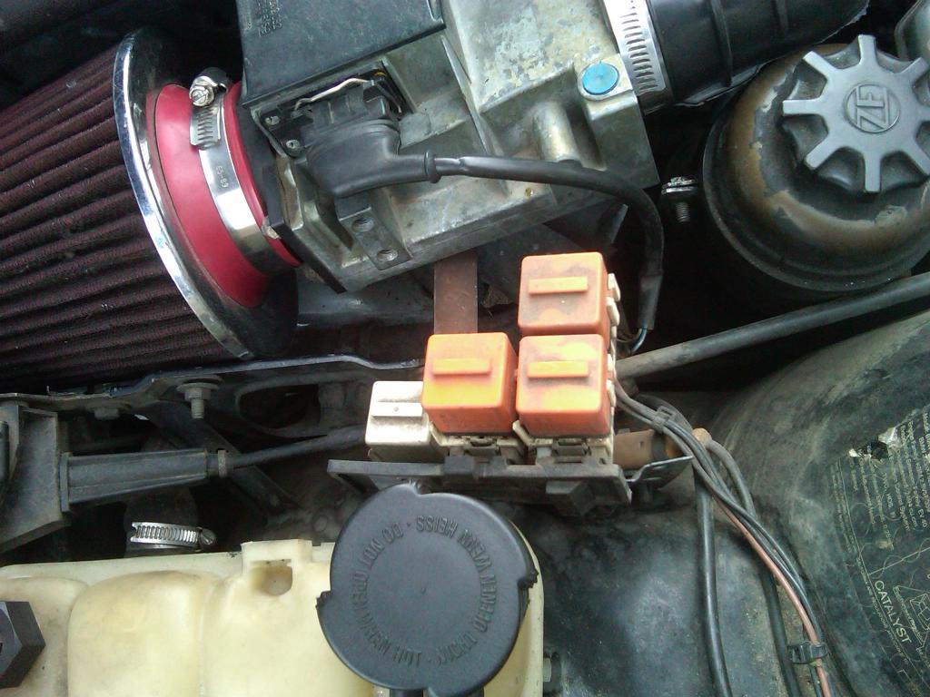

              Which one is the Fuel pump relay?
              • blocke
                • 1305
                Orange one to the right of white one I think

                    Of course no one had the fpr so I ordered it. I am going to check the fuel pump connection tomorrow and check the spark. I pulled out the spark plugs today and they looked like they could use replacing so I did just for shits and no difference. I'll keep everyone updated
