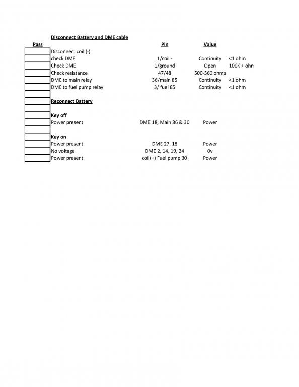

            have you tried a stomp test?
            Attached is a list of checks that jlevie told me to check when I was having no start issues after putting a motor into my pro3 race car, it's a great way to check all of the electrical circuits that are needed for a start to occur. If you have fuel and all of theses tests pass, then there is something weird going on possibly a bad DME.
            When I say DME I mean the DME connector on the harness side so it will require the removal of the DME.

                            • tunethtmkII
                              • Apr 2011
                              • 297
                              so i pilled all the plugs and turned the motor over a couple times to get the extra gas out of the cylinders. then re intalled the plugs and wires. then i installed the new cps and turned the car over. still no start.
                              now im left with a possible fuel pressure problem?
                              fpr?
                              i dont have access to as fuel pressure gauge. is there any other problems that may be occuring with the dme?
                              what is a stomp test and howd do i go about performing it?
