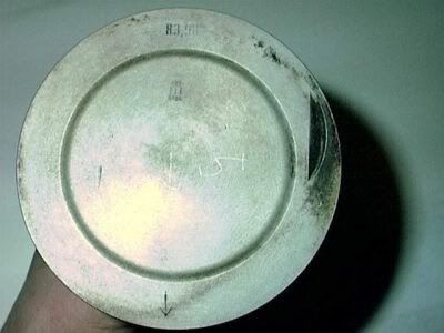

              Give you an idea of what im talking about;
              eta piston with a dish in the middle:
              The ones in your 320i would normally either be totally flat or have a very slight dome to them. Have them milled down, could drop the compression a full point pretty easily without going to the cost of custom pistons and/or rods. Also means you dont have to try and keep the motor together running a thicker head gasket.

                  obviously just depend on how much it would cost to have them machined, a dish might be more difficult than just having them machined flat (so I would probably just go flat), but I know 100% for a fact the compression height is much larger on the 2L vs the 2.3L which share the same block and rods. If you arent looking at massive horsepower, I reckon this makes the most sense and could get out of it without spending a lot of money that you could probably use to freshen up the 2L motor.
