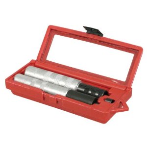

    I've used one, but not while the head is still installed. I've heard people doing what your attempting with success though. Give it a shot, but be prepared to pull the head given the worst case scenario.
    AJ

    started a topic Any one used a Valve keeper removal tool?
    I got a 88 super, it has a 885 head. I have gutted an "i" head for the cam and springs. I dont wanna pull the head. Anyone used this
    Lisle 36200 VALVE KEEPER REMOVER AND INSTALLER TOOL
    Or Lisle 36050??
    Has anyone used it on our heads?
    I plan on puttin compressed air in the cylinder to keep the valves up while the piston is at TDC.
    Input??
