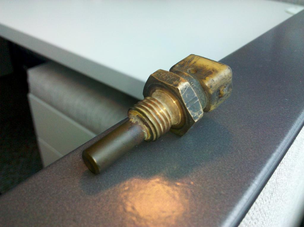

I just bought a brand new white sensor here in Argentina, was the last one on the $tealer.
Thanks for your input jlevie.
In a glass of cold water is measuring 2900-3000 ohms
in a glass of hot water from the dispenser is measuring .67 and going down.
So i suppose that this one is working fine.
I would provide a new update today at night when the new sensor is fitted :P
