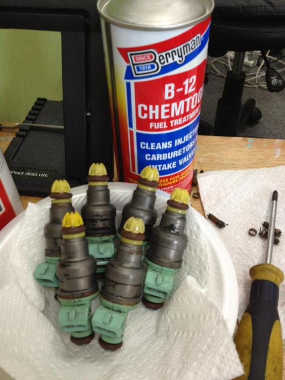

Put in some 17lb injectors today!
  • jink0619
    • 808
    .....and i likely!
    Car runs nice on my M20, slightly smoother and throttle more lively, overall im very pleased.
    The injectors were from a M50, bought the service kit and replace the
    pintles, filters and O-rings.
    Installation was pretty easy, hardest most frustrating part was trying to get
    the clip off the harness where it plugs into the injector plug. Theres no room
    to play with in there so i removed the valve cover for alil more room, used a thin 10mm socket to remove the 4 10mm bolts thats holding the rail to manifold.

    17lb injectors prep and cleaned

          Where did you get the rebuild kit at?
          I have a set I want to rebuild.

                  I got this kit

                        I am a fan of the M50 injectors in ANY M20 engine. They really do make it run smoother.

                          Completely agree. I also just put in M50 injectors this week. Engine definitely runs smoother. Some of that is also probably due to the fact the stock injectors were nasty when I pulled them LOL.

                            Should work fine, my kit came with a screw used to pull the old filters out....genius idea!

                            yup....so smooth :D it might just be in my head but it feels faster too, glad i got around to doing it...next on my list is getting the A/C back in the car, summer is around the corner.
