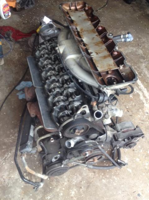

    Alright to start things off, i bought my first e30 (87 325e) right about a year ago and i was hooked. Soon i found out the motor in my car was already a stroker but running on motronic 1.0 wtf? So swapped in motronic 1.3, I intake, 19# injectors, timing belt, water pump, Power steering and A/C delete, plugs, wires, cap and rotor. I like the power but i want more. i want boost.
    So with $450 dollars in my pocket, i start collecting engines.
    First, 2 eta engines. One complete, the other just the block and rotating assembly along with two engine stands for 300
    Next, a complete I with auto trans from an m-tech vert with only 130k on it for 150 bucks. Oh and the guy also had two super clean m-tech 2 alpineweiss verts. so jealous.
    Anyways, the plan is just a basic rebuild and prep for boost as of right now. I am reading Maximum Boost by Corkey Bell at the moment so as i am building the engine i will be choosing the right parts for everything to work in harmony.
    As of right now, the plan is:
    eta crank
    eta rods
    I pistons
    balance rotating assembly
    new rings, bearings, and seals
    clean up the block/head surfaces
    O-ring block
    30# injectors
    PnP megasquirt
    and a few other misc things before the full turbo setup is figured out

    You know you will have to deck the block around 2mm for those pistons to work, right?

      It's running motronic 1.1 because it's an eta engine. You shouldn't rev that head over 5k.

        its an 885 head on it already. thought i mentioned that. my bad.
        kind of a long story but when i bought my car a year ago, i got it for 850 bucks with a bad water pump. got it home, did the water pump, timing belt. summer comes and i go to the junkyard, pull an 885 head and intake (and all the stuff for 1.3) pull the intake manifold off my car and it has an 885 head already and the block has 26 05 88 on it. my car confuses me lol. i hate not knowing exactly whats in it.
