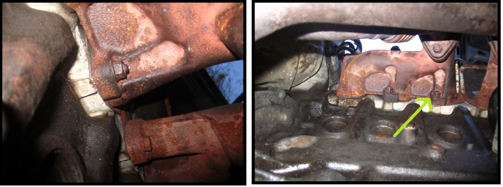

    I thought I could drop the exhaust a little by simply removing the muffler and exhaust pipe supports and be carful not to let it drop too far. Shouldn't it drop down a little if it is just help by the manifold?
    I just need a little room at the top to get a straight shot to the nut and to try to pound on a socket, or the "reverse thread socket" mentioned above (never used one, but it sounds interesting).

                I got 3 of the 4 bolts off tonight. They must have been 12mm at one time, but rusted to 11.5mm. A 12 mm was to big and a 11 would not fit.
                I ended up pounding a 7/16 socket (let's see that would be 7/16 x 25.4mm/inch = 11.1 mm) on to the bolt and then using a 4 foot extension on the socket. This allowed me to get far enough away to use my breaker bar and a lot of torque.
                I had disconnected the muffler to drop it down 6 inches and get a straight shot to the top bolts.
                The bolts had be soaking in PB blaster for 3 days, but in the end it did not matter, because 3 of them broke before the bolt even turned one mm. The last bolt is still on there and I can't seem to get a grip with the socket. I may cut that one off. Always a battle with exhaust bolts!

                  Aside from soaking them, I used 3 wobble extensions (one on top of the other) and came at the bolts from under the car. I used a 3 foot breaker bar to get them off. To get a grip on the last bolt maybe try using a C-clamp to push a smaller socket on. Just a thought.

                    I am having the same problem with the manifold bolts. I think I may have rounded one off. All of them are lose except the one. Strange clearance issues in this spot.
                      make sure you use 6point 12mm for those and the 2 under the spouts need to be broken loose with a box wrench. use a torch to warm them, they shouldn't be all that hard if you use 6pt sockets. <.< had to remove those off of 8 heads so far. never had one get the best of me yet.
                        This!
                        Use a box wrench to break them loose. Make sure you use the closed end.
                        I've taken off 4 heads and never had an issue.
