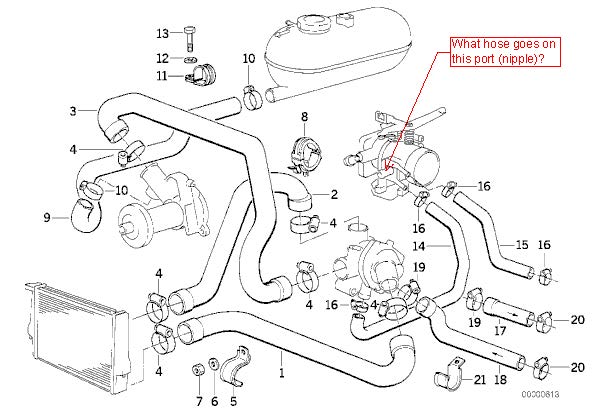

Missing a hose at Throttle Housing.
  • amcink
    • 788
    I need to know which is the hose that goes on the throttle housing per the attached graphics.

    VC breather?

        Sorry! No! the VC breather is already plug is a smaller nipple behind the VC breather

          That nipple is for the hose that goes to the valve cover. The smaller elbow nipple closer to the intake is for the ICV.

            I have a 1986 325e and the nipples that show on the graphic are all on the right side. Therefore, I do not know if that small nipple behind the VC breather is for the ICV, can someone confirm please.

                Carbon canister.

                  You sir hit it on the head. Is the Carbon Canister hose. Thank you

                    Yup, the one on the side of the TB facing the front of the engine is for the valve cover breather thing
                    The fat one facing the driver's side is for the ICV
                    The nipple hidden way up underneath there goes to the carbon canister
