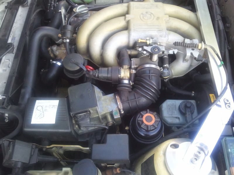

                  So I'm back...
                  Checked the C191 harness connector on the white DD car and it seems ok. Drove the car to work today for the first time and it really doesn't drive that bad. I think that most of the problems stem from comparing it to the other track car more than anything that's really wrong with it. I'd have to say that the throttle response "hesitation" I'm experiencing is more akin to driving with a very large marshmellow underneath the gas pedal. I have to physically press the pedal down harder and sooner than I'm used to in the other car, and I translate that as a lack of throttle response.
                  Now for some pictures...there are some curious differences between the two cars engine bay:

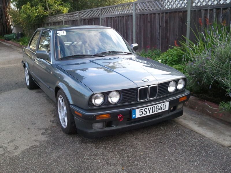

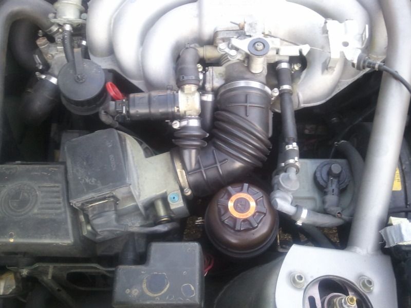

                  First off, Track car the first week we (GF and I) bought it:
                  Engine bay of the track car:
                  *notice the cruise control delete
                  Engine bay of the new White 325is:
                  *If you look at the vacuum line on the brake booster it is significantly different than the track car. Why? No idea.

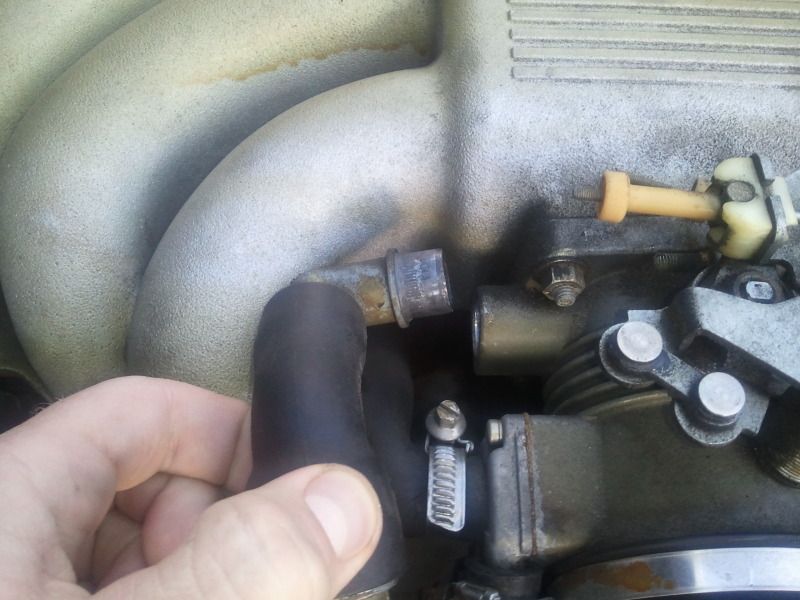

                  This part comes out quite easy, is that bad??
                  • sector6
                    • 909
                    Don't have an answer for the other questions, but this was the same on my car, slid right out. Not sure if it is suppose to, I just put a small amount of adhesive silicon on there to hold it in place a get rid of any leaks.
                    • dnguyen1963
                      • Nov 2011
                      • 2651
                      JB weld that sucker to eliminate your vacuum leak.

                          Yes please jb weld that.

                            That loose elbow is one intake leak and I'll bet on there being others. Have a smoke test run.
                            Clean the nipple and socket with acetone or lacquer thinner then apply JBweld. Let the car sit for 12 hours for the epoxy to set up.
                              Well I had the timing belt, and other accesory belts, water pump, and camshaft seal all replaced yesterday. My buddy did all the work and he appears to have put some sealant on that loose elbow. The car drives much better now, and revs up a lot easier. Next thing is a smoke test and save up for exhaust and MAF conversion.
