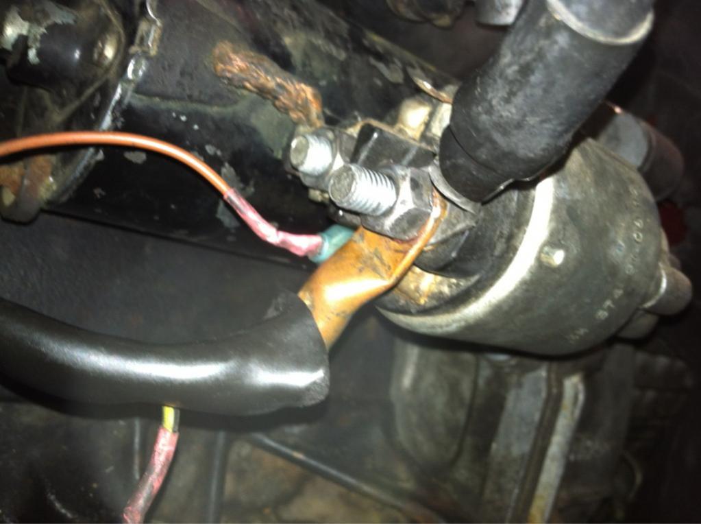

        Hmm alrite well here are some pics of what's going on, there's some wierd stuff going on so maybe I can get some clarification Click image for larger version
ID:	7144978 kind of confused with the 2 connected wires that are blue/yellow and blue/white....seems like something's not right here...
          I agree that what you have looks strange. The crimp connector certainly isn't OEM.
          What car is this and does it have the original engine and harness?
          Jim Levie, Huntsville, AL
            85 325e with a complete i top end...

                  Does that include the M20B25 AFM, CPS, injectors, engine harness, and DME?

                    Need to check out the engine harness but it has the I intake manifold, head, afm, distributor, aftermarket blaster coil, and I spark plug wires...I think that's it haha
