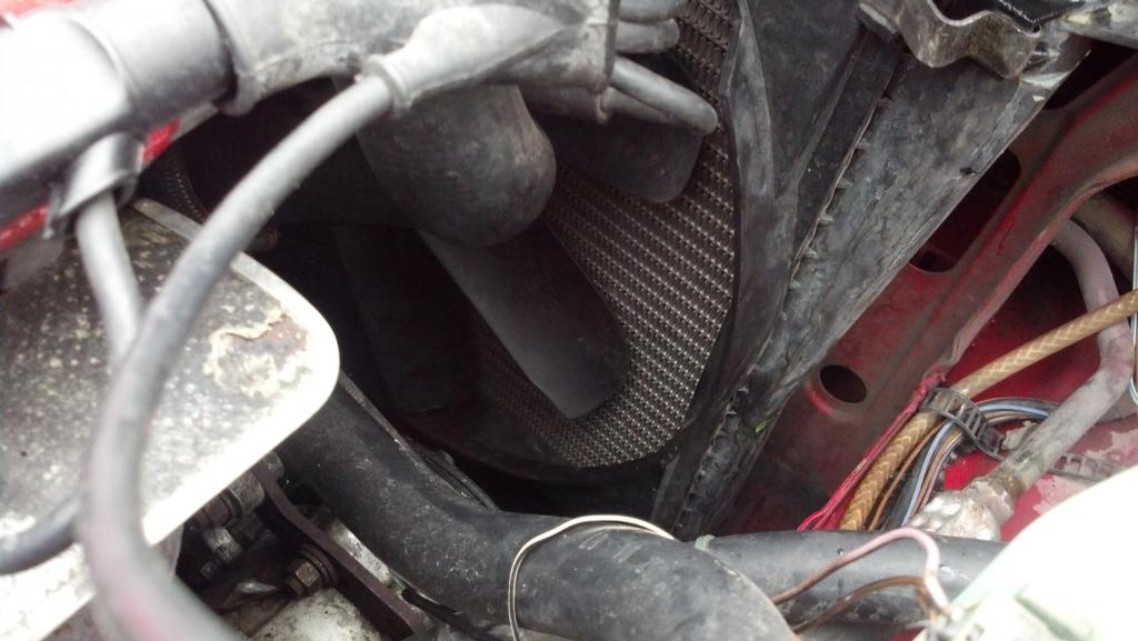

                  so took it for a drive, no dice
                  But i was looking and it seems the fan is offset from the shroud. The shroud is installed perfectly, the two tabs at the bottom and the 2 clips up to. I moved the shroud a little and the fan began to spin...
                  Perhaps its just being caught up. But how can I adjust this. It only goes on one way right????

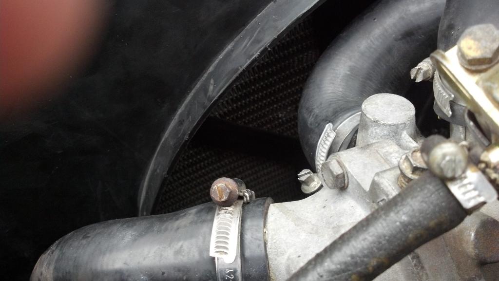

                    pics

                      also how easy should the fan have come off? I had to like pull the radiator too the front to get it off the threads... it seems really close to the radiator
