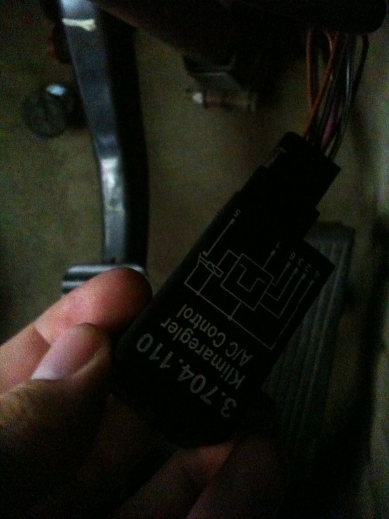

                  • Mr. Tasty
                    • Jul 2011
                    • 3421
                    its happening again, my air conditioning worked earlier today. Hop in my car again to do an errand, and no air conditioning plus popping noise. Sounds to be coming from below and to the left of the kick board on the driver's side. This is really puzzling.

                        • Mr. Tasty
                          • Jul 2011
                          • 3421
                          car is doing again. It is making the same popping noise that triggers the a/c. Think it could be the bad switch? or maybe something under the dash? I do have to lightly smack the dash to get the tach and fuel efficiency going.

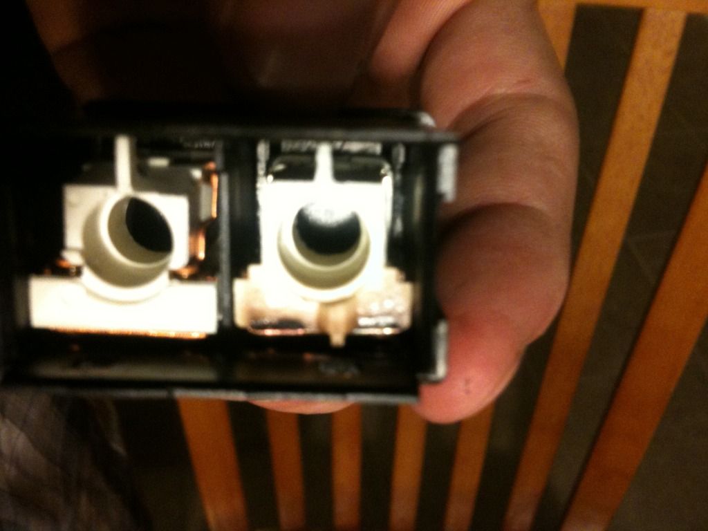

                          • dnguyen1963
                            • Nov 2011
                            • 2651
                            There is some serious arcing in that switch. The popping noise is probably the result of that.
                            • Mr. Tasty
                              • Jul 2011
                              • 3421
                              this is the relay that keeps clicking. All connections look clean though... any idea?
