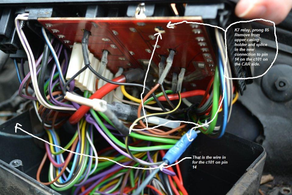

                          The K7 relay to pin 14 on the c101 fixes the starter for the newer jetronic firing of the solenoid retraction. Tells it when to stop firing after it kicks over the starter to turn over the engine.
                          The 325ic 87 harness is the same since it is using the b25 engine.

                              This is the wiring for the starter from swapping a b25 into a b27 spec e30(my sister's). Motronic uses 3 wires for the starter apposed to the jetronics 2. What I did was run a female connector from the c101 to the k7 relay and on the 85 prong I removed it and spliced the new lead into the relay.
