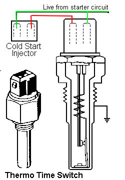

                            What I think I'll do is this: Using my voltmeter, on each plug (thermo-time and cold start) I'll check for voltage on the starter circuit, connecting the ground of my multimeter to chassis.
                            Then I'll check for continuity between the two connectors on the other line (which is essentially the ground I believe). Question: do I need to disconnect the ECU before doing this particular test?
                            Last edited by mrgraphics; 10-25-2012, 09:54 AM. Reason: Attached images not showing up.

                              Interesting results:
                              Cold, the plug to the Thermo Time switch has a ground and 12V. Just as it should. However, once it gets really hot in the engine bay, both sides of the plug go hot (12v). Continuity to the cold start injector is always maintained. But instead of ground, it's also getting double 12v.
                              I had a small fire a long time ago at the FPR, and that plug got pretty burnt - not melted but crusty. I think what is happening is that as the plug gets hot, there is a small amount of expansion that causes the 12V side to contact the ground. That also causes the Thermo Time Switch to get double 12V. Since it gets ground through the plug itself, I'm sure it's getting quite hot, which is why it takes so long to come back to a reset / cool state (it no longer corresponds to the coolant temperature.)
                              I'm going to cut the old burnt connector off and solder on a new one, and hopefully that fixes things.
                              • mrgraphics
                                • 221
                                I rebuilt the wire harness and it's still doing the same thing (Thermal switch sending 12V along ground to cold start injector.) There is a short somewhere else.
                                So I simply disconnected the plug to the thermal switch, and made a ground connection jumper wire for the cold start plug. Yes, it always fires when I start, but once the car starts the cold start injector turns off. It just means on hot start it revs a bit higher than normal at first.
                                Yeah it's a hack, but it's also an e30.
