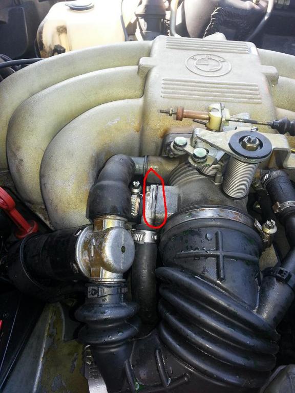

    Throttle body coolant leak!
    So I smelled coolant. Checked under the hood and this is what I saw.
    see attachment
    That little gasket is leaking bad. I heard there is a temporary way to bypass this and still function correctly. Can anyone shed some light?

      The workaround is to loop the two hoses that connect to the TB heater.

        What is the part number for this gasket? I can’t find it on realoem M20B25.
        thanks!

          13541285471​
