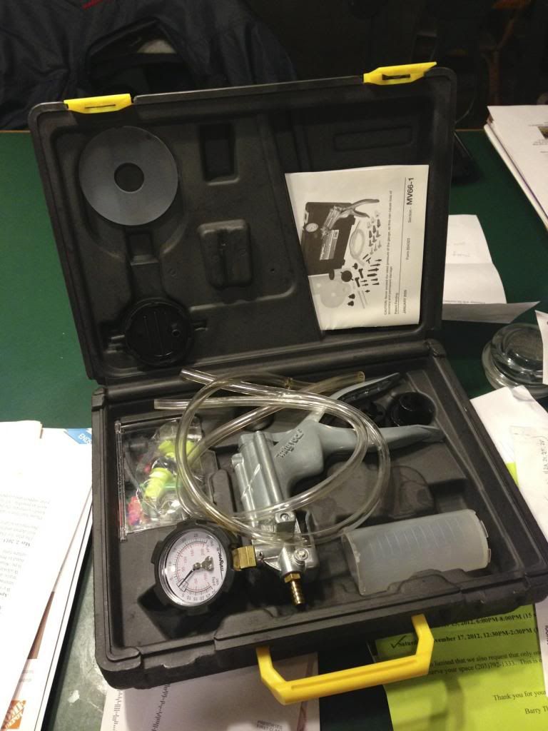

    Borrowed a mityvac vacuum tester today
    Hooked it up to the intake manifold, and at idle the vacuum was a steady
    13 Hg. When hooked up the idle remained choppy.

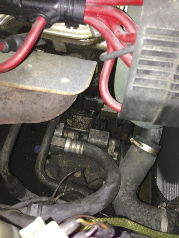

    Then I noticed my valve cover:
    Obviously the gasket needs to be replaced, but should this fix my idle and low vacuum?

    Have a shop run a smoke test. That will tell if if there are intake leaks (very likely) and where they are.

      You have found at least one of your vacuum leaks...smoke test will find the rest.
