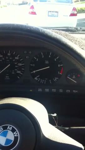

hard start video
    hard start video
    thoughts?
    im thinking fuel pump?
    How does it run once its actually started?

      ZERO issues
        if its a pre 09/87 325i, then it has the dual pump system. Usually what happens with those is the in tank lift pump fails leaving all of the work up to the external high pressure pump. It will work for a while but then eventually it will cause issues.
        I think what you're experiencing is the high pressure pump struggling to get enough fuel to the motor. Then, after a few tries, it has enough pressure to get the motor fired.
        My advice, get a new lift pump AND high pressure pump Although, you will probably be able to get away with JUST replacing the in tank pump.

                      Before you start replacing parts diagnose the problem. The first checks would be to:
                      1) Have a smoke test done and fix the leaks it reveals.
                      2) Tee in a pressure gauge and see what the rail fuel pressure is/does when starting.
                      3) Check the ECT sensor, at the sensor and at the DME connector.
                      The in-tank pump from a later model can't be used as is because the assembly doesn't have the fuel return fitting. The in-tank pump could be bad, but I doubt it is the cause of this. When the tank is above 3/4 full (as it was in the video) a failed transfer pump usually doesn't cause any problems. The effect of a failed transfer pump becomes progressively more noticeable below 3/4 of a tank. But in any case you can test the pump to see if is working.
