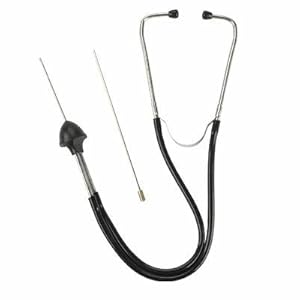

    My first step would be this...
    • Tyler325i
      • Jul 2011
      • 64
      Never really had much luck with those...
