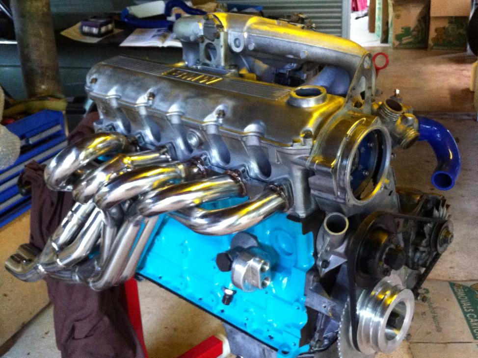

    Hi Everyone
    I am currently in the process of building a circuit/tarmac rally E30 2 door. I have put together a 3.1L stroker kit from IE and also replaced the entire valve train, upgrading to OS SS valves, Schrick Comp Springs and a 304 degree cam. I also have custom long tube headers and will fit a free flowing exhaust system.
    The ECU/EMS I will be using deletes the AFM/MAF and uses a MAP sensor, also, delete distributor and utilise a magnetic pick up on cam gear. This means I can tune each cylinder for fuel and spark individually.
    I have thought about using and E36 M3 throttle body, If I can find one, or an E34 M30 TB.
    I dont have the money for ITB's even though I know this would be an ideal setup, I was hoping someone could point me in the right direction.
    For the engine will remain NA as the custom pistons have been made for 10.5:1 compression, and I would have to lower that significantly if I wanted to use forced induction.
    I welcome any feedback regarding this.

                        I have no idea. But I APPROVE!!! That looks real nice. Nice build.
