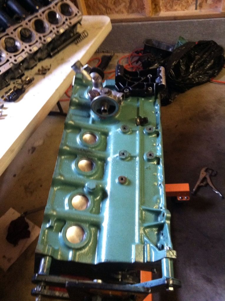

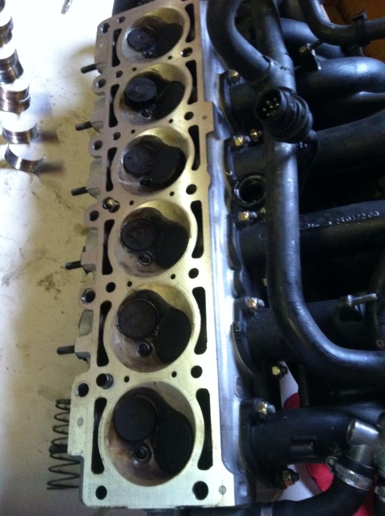

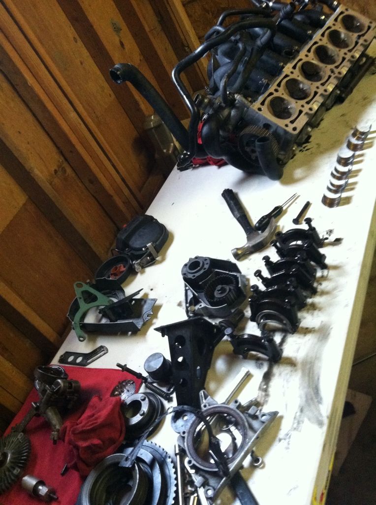

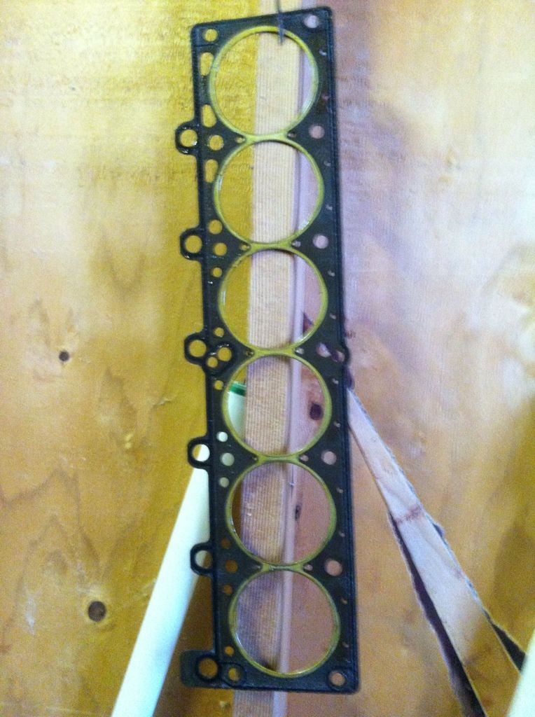

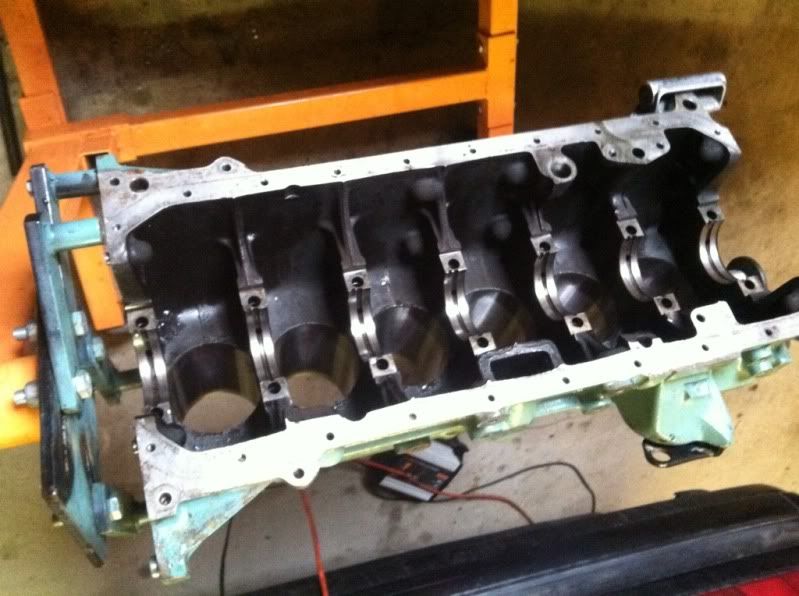

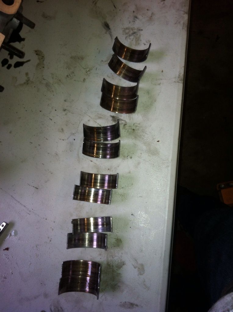

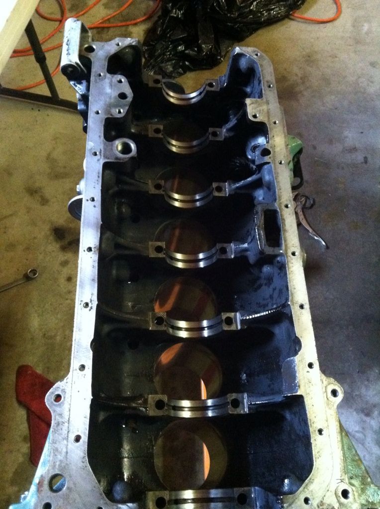

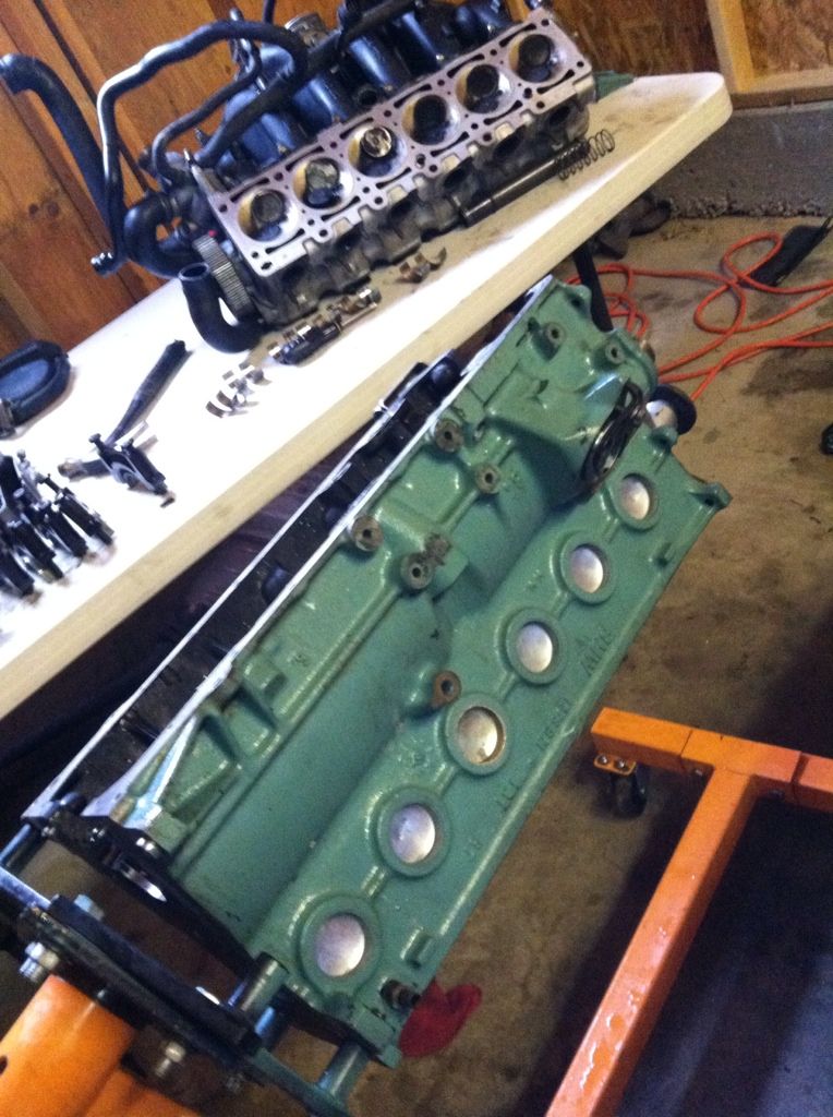

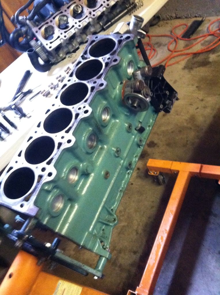

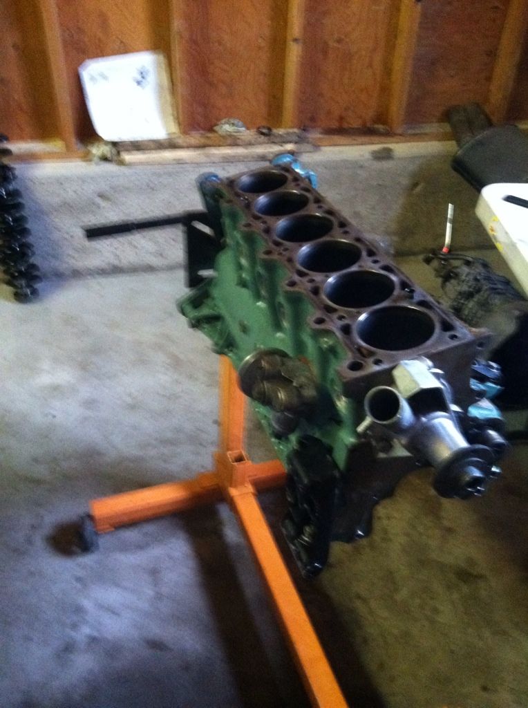

      so im pulling the motor tomorrow . i will post some pics on this thread of the tear down . to show you what im working with
