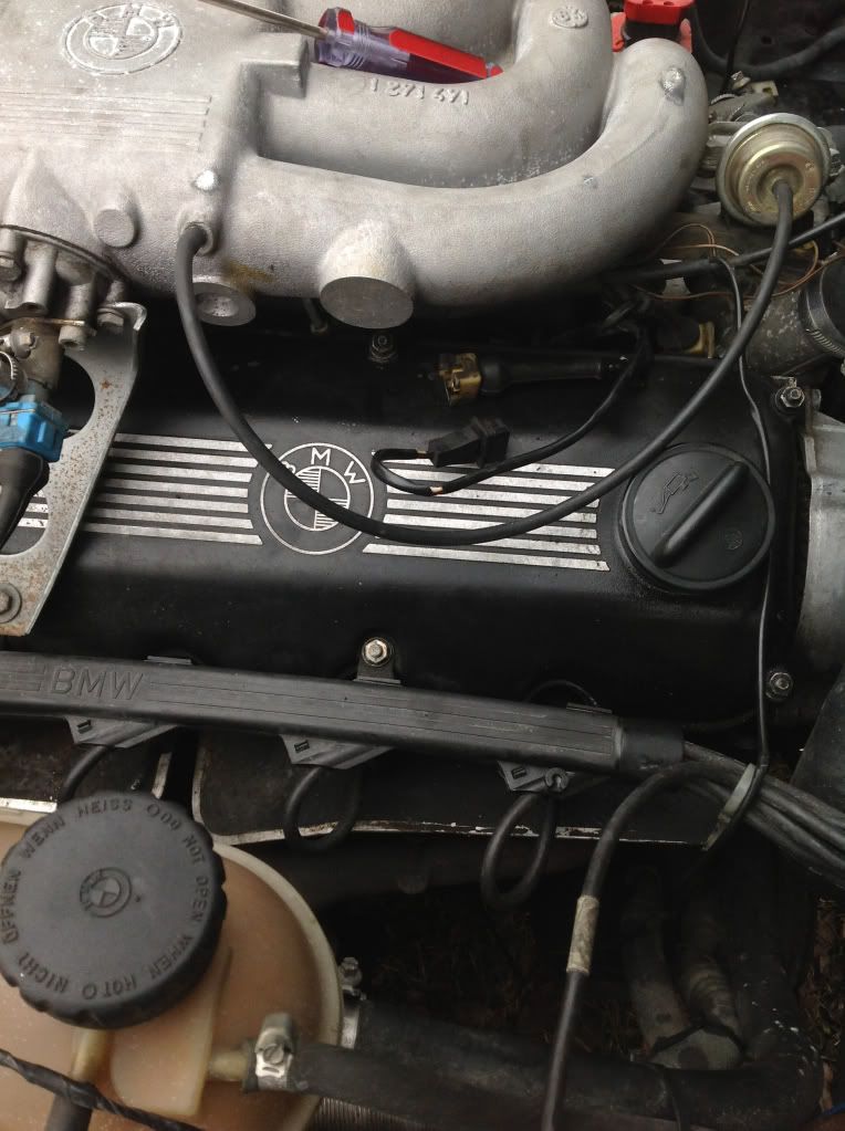

    Still having a problem getting my car to run. It starts and then dies. The car keeps running if I keeping cranking. The car also runs for a bit if I unplug this plug. So the question is what does this plug go to.

      one is for the front cps driver's side near crank

        It's an eta so there is no cps on the front?
          there is but it's not the same as an I's cps
          do u have the one that is plugged in on the front of the housing. u can see in my pic

            That's a different harness then mine. I don't have the round style big plug by the fuse box.

                Yes now I see what your meant. So that plug goes to a cps in the front?
                  Is it part 11 the pulse generator?
                    no, that is for an "i" model
                    your eta has the CPS in the back, not the front

                      That's what I thought.
