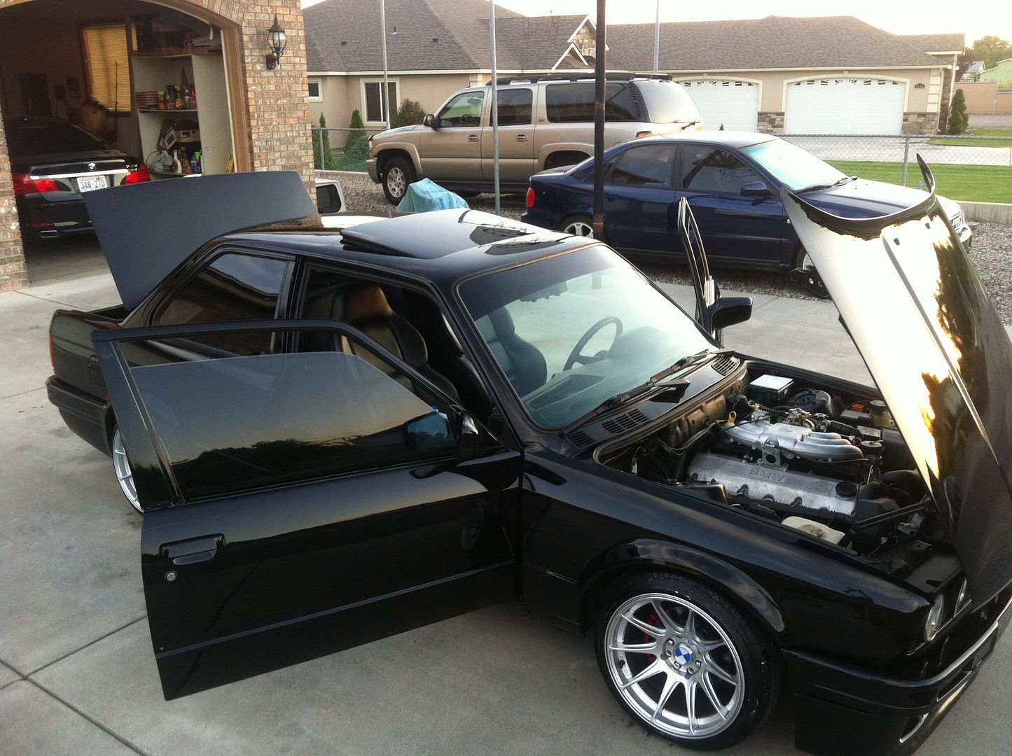

    First and foremost; this is my car.
    1990 BMW E30 325i 2.5l
    A little bit of back ground history. Bought it back in September 2011 for $500, in terrible condition.
    New Paint (Schwarz 668 off my E90), New Wheels, Rims, Windows, Full mtech 2, M3 vader seats, trany, head lights, tail lights, rear leather seats off an import e30 at a junkard, led interior lighting, etc etc.
    So as you can see, ive put alot of time and money into my car, and now finally, my engine is on the verge of being replaced.
