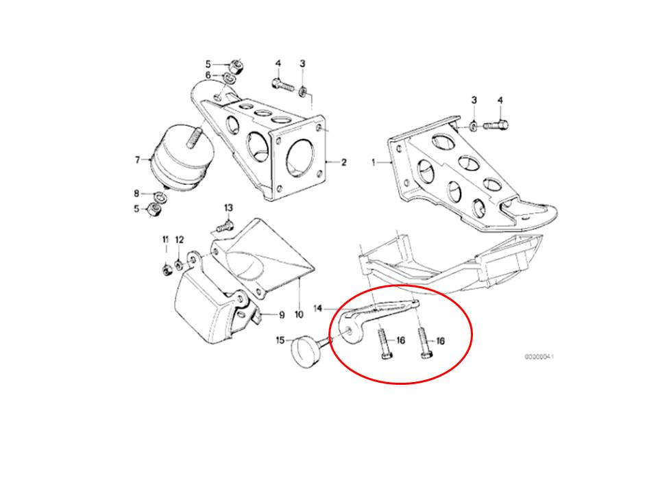

    What does this thing do?
    it's a bracket mounted on the bottom of the bellhousing support on the bottom of the engine.
    On the microfiche it says this is some kind of a "stop" but I can't see what it might stop. it's close to the anti-roll bar but that doesn't seem right. The microfiche shows a rubber stop but mine didn't have it.
    I took it off when I did my oil pan gasket and I haven't seen any ill effects.

    it's a vibration dampener bracket, goes into a rubber thing on the subframe. You don't really need it.

          The thing above? I don't see where it could connect to the subframe.

            It keeps the engine from falling back against the firewall when the transmission is removed, it rests against the cross member under the engine.

              ah- i guess i should buy the rubber part and put it back on. thanks

                That part is there so when you slam on your brakes the fan doesnt grenade the radiator when your motor and trans mounts get wasted after they are not maintained.
