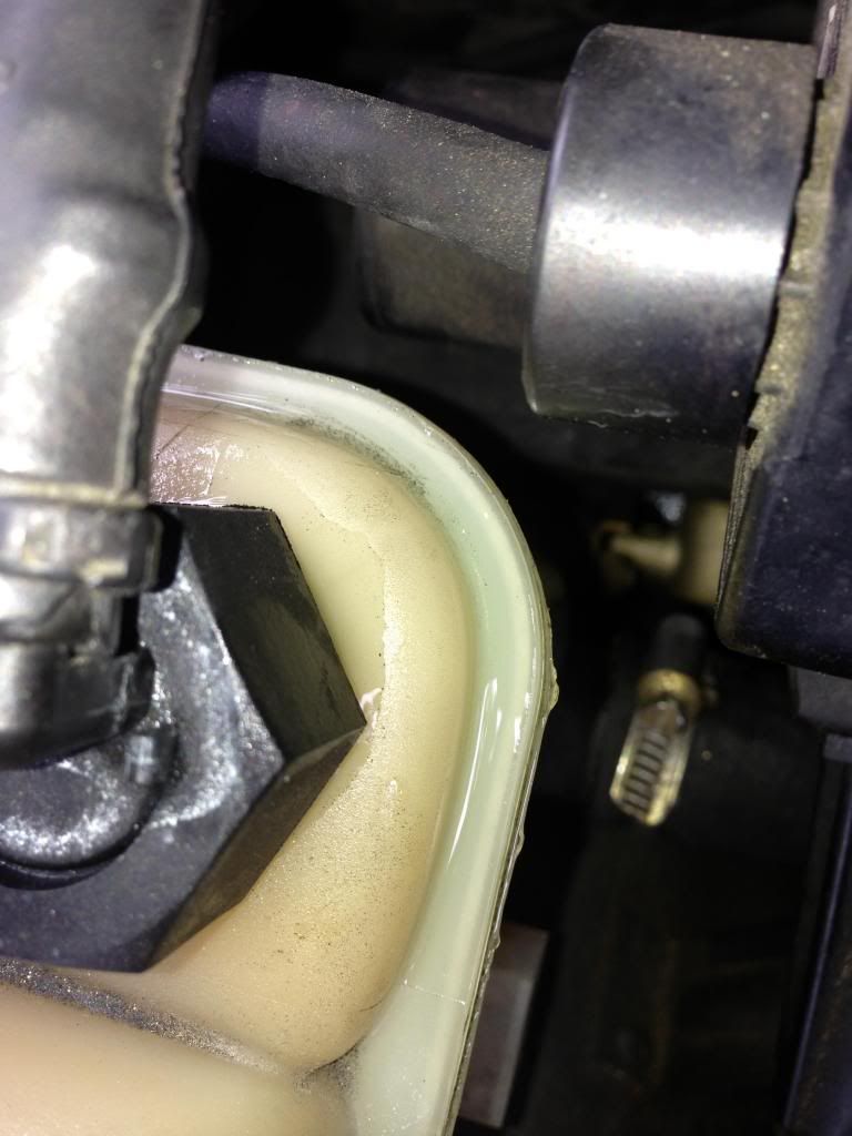

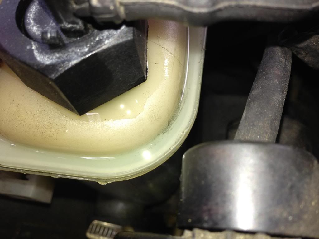

    I have coolant leaking out of the expansion tank this is a picture i took while the car was completely cold it leaks more after a drive or while driving do i need a new sensor or is there too much coolant in the tank?
    Also can anyone please tell me what part this is?

    well im having coolant problems but from my understanding it should come out the overflow when filled too much so id say there may be a crack right there
    • oliver.r
      • Mar 2012
      • 3839
      looks like you need a coolant tank
      that part on the bottom is a a/c compressor
