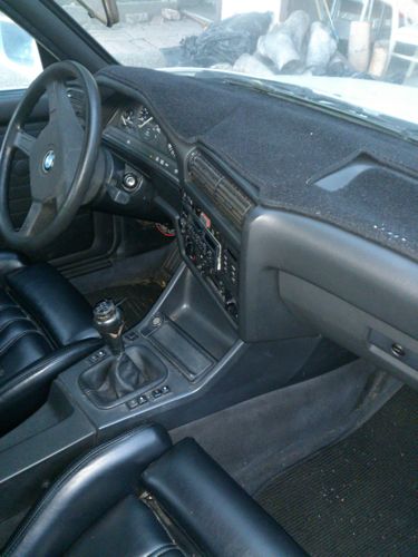

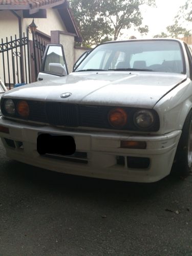

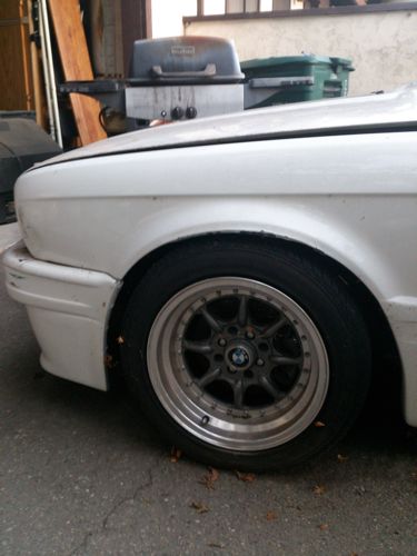

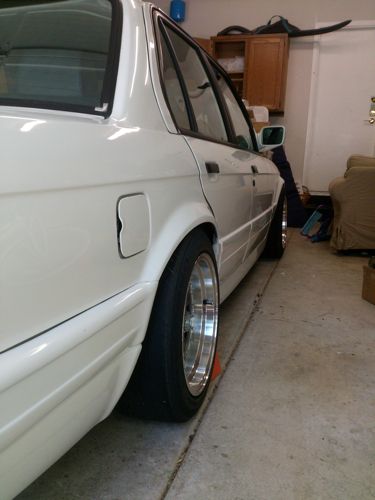

    I have a newly acquired '87 325e. I have never owned a e30 generation BMW. I do not know much about this car, but I am reading about them. Here are some pictures, I have some comments/question at the end:

          The car looks decent overall would love for somebody to give me a Mtech2 sedan. That body kit alone is worth $1500 lol
