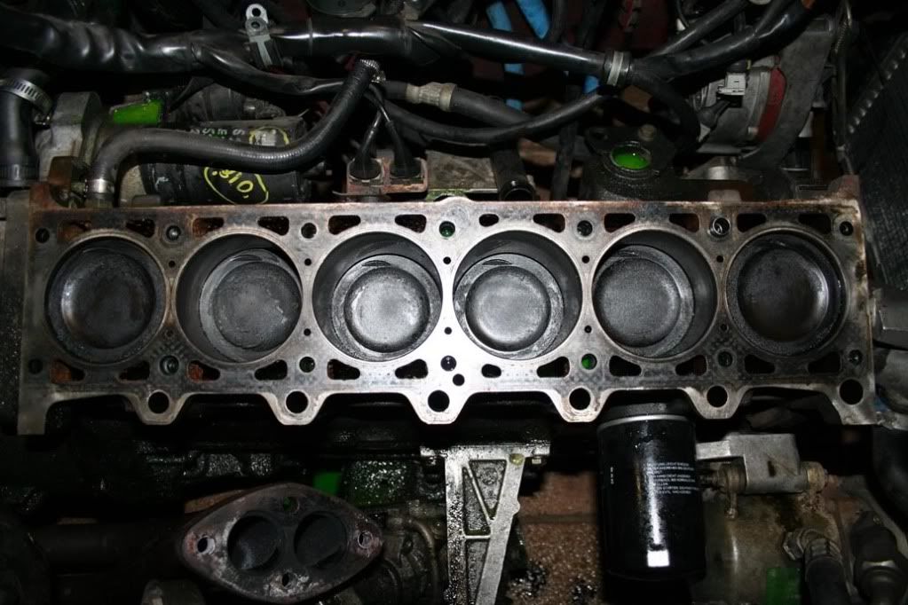

    I'm assembling my e motor for a rebuild and I just want to make double sure that the valve relief in the pistons are for the exhaust valve. That's what I'm thinking from the tear down but I just wanted to make sure.

    Pic i found on the internet. Looks like intake reliefs which would make sense since the intake valves are much larger than the exhausts.

      Thanks...I was searching myself..
      Came back to edit to intake valves…
