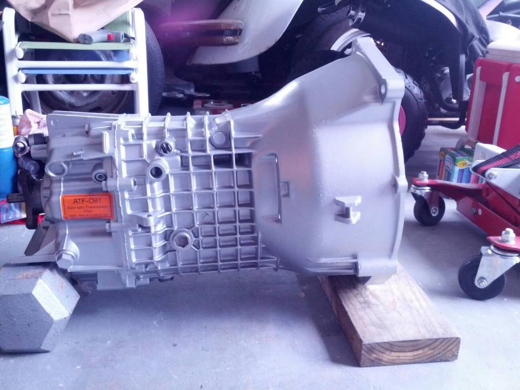

        Ahhhh...sounds like the Getrag rattle. I just fixed my trans from doing that.

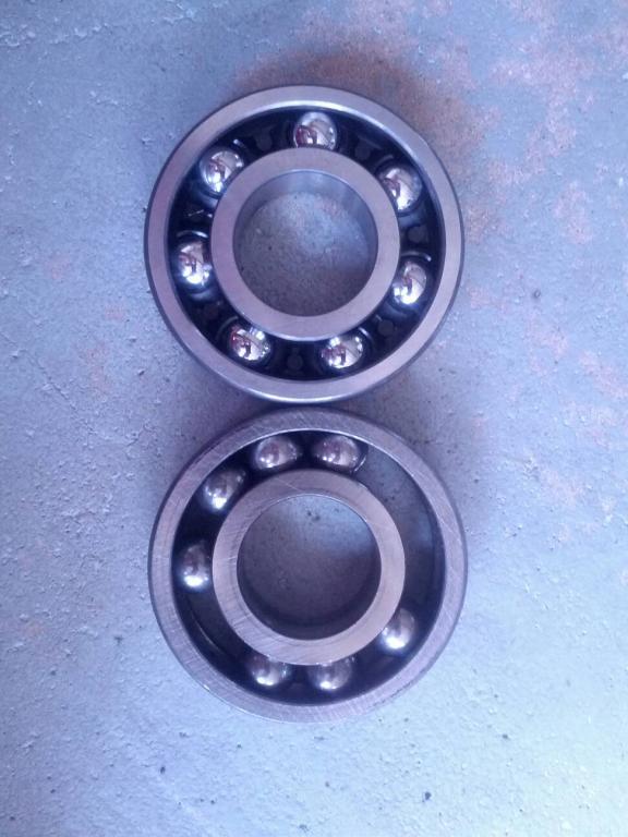

                Getrag rattle is not the release bearing, its the input shaft bearing and or the countershaft bearing.

                I couldn't live with it so I opened up my trans and changed bearings.
                Sent from my Galaxy Nexus using Tapatalk 2

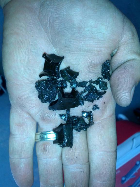

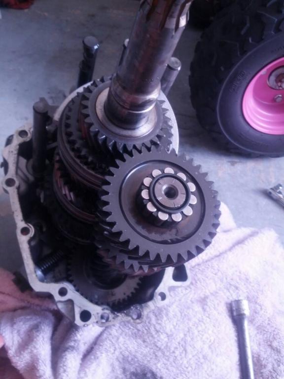

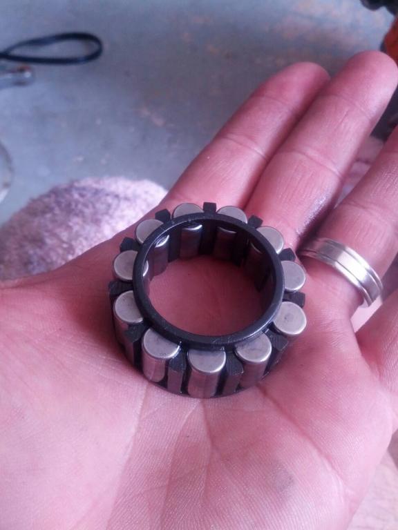

                    No, its usually either the input shaft ball bearings slapping against each other like in my case, the countershaft bearings slapping against the dust cover/seal or both.
                    As it cab be seen in my pictures the old bearing was missing the plastic retainers that keeps each ball bearings separated..mine cracked, chipped, broke off and caused ball bearings to slap against each other.
