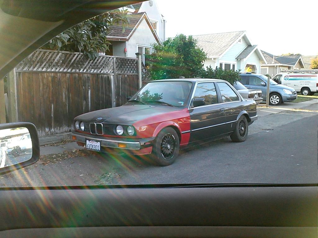

      Thank you, and i will post some pics in a bit, just be warned that the car has red fenders and no grill yet.

        And for the pictures.The front end picture is from the day i bought it, i removed the kidneys and grills when i changed the timing belt and broke one of the grill :(

          what year is your 323? depending on the year, it may have a 200 or 731 head, the 200 on a b23 is essentially the same head as the eta. the plugs for both the 731 and 200 heads are the same as a 325e. most parts will be common enough that you can find whatever you need just from a different model number.
          Welcome & please do post up more pics of your grey market! they all seem to have a few unique things about each one that is not common in the USA cars. ...like mine had aluminum motor mount arms on my grey market instead of the common/heavy steel ones.
