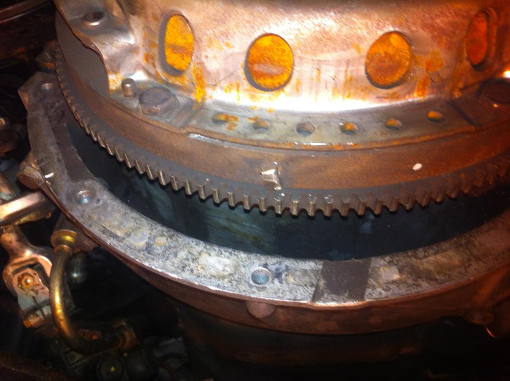

    I have a 1985 bmw 325e and its not cranking over. i heard their is a pin on the flywheel and i took a picture of it..

                            My gut is telling me it is the flywheel, I'm not sure though, heres a picture of a flywheel with an acceptable reference pin,
