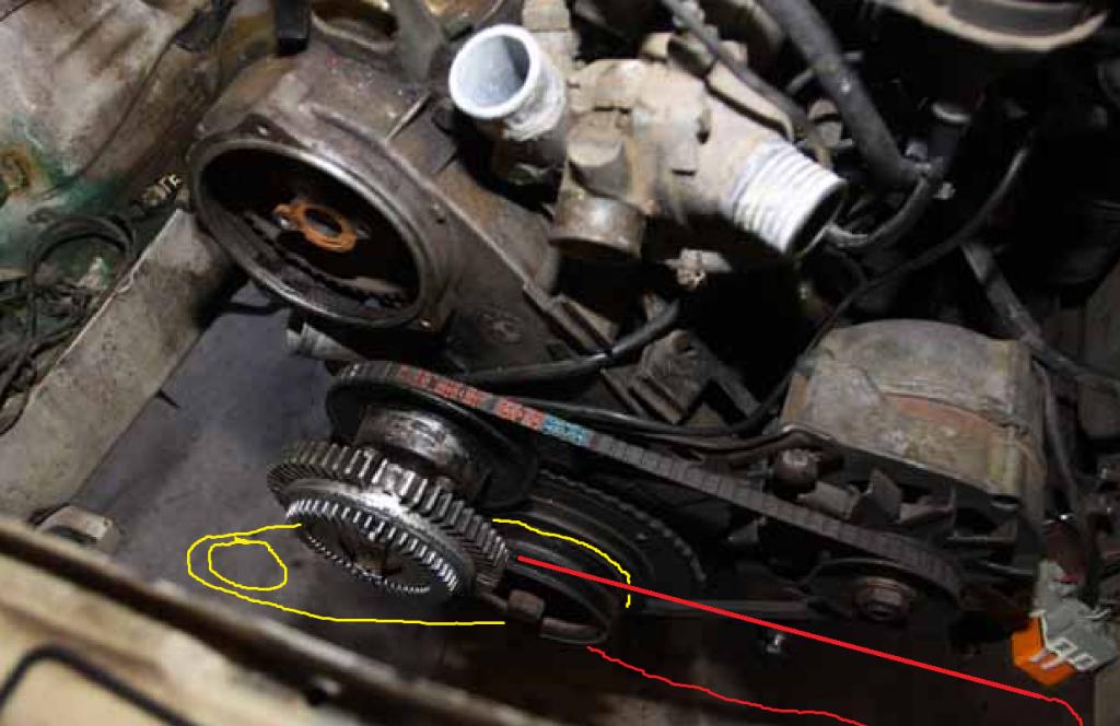

                  Here's a picture of a of an engine. I believe it's an m20b27. Is there much difference from the m20b25 when it comes to V-Belts? I read that it has a different higher stroke so I'm assuming the engine practically looks the same probably.
                  Can someone show where each specific belt goes? Like draw it in ms paint for all I care. The PDF Bentley I have has impossible to see images which makes it of no use to me.
                  I'm thinking I'll do a write-up/DIY for the next noobs after me to come, but I need the right info to un-noobify my experience. lol. So who ever has the time and knows for sure which one goes where, please help a brotha out. Thanks in advance!

                    • susej1981
                      • Jun 2013
                      • 90
                      this should help, someone correct me incase I make a mistake. the photo should look familiar as that's what you're looking at with your engine at the moment. the belts you bought should be labeled. if not, look up the part numbers on a site like bmaparts.com and it'll tell you what each part # goes to.
                      the belt in the photo that is already on connects the alternator and the water pump together. this belt takes up the pulley closest to the engine block, furthest back pulley from the front of the car.
                      the yellow lines I drew in are for the ac compressor. this belt comes next, and is the middle pulley out of the three pullies on the crankshaft bundle of pulleys
                      last belt, the red lines I drew in are for the power steering.
                      when putting the belts in, go from back to front it's the easiest

                          Thank you very much! Exactly what I needed! Yeah, the belts were labeled when I bought them.
