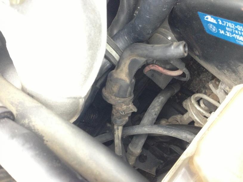

              I see that this is rubber hose is really shot on my car. It connects to the brass nipple on the bottom of the throttle body next to the TPS. Also eventually connects to the charcoal canister. Anyone know a Part number? Cant seem to find it on realoem.
              • jlevie
                • Nov 2006
                • 13530
                I think I remember some folks saying that the hose is NLA. You can use a piece of ordinary hose.

                        The hose I mentioned earlier that connects the charcoal canister to a check valve and then to the throttle housing I ended replacing. This did smooth things out a bit and believe it was one source of my intake leak.
                        I built my own "smoke tester". I realize this is not the "proper" way to test and I am not confident that I found all of my intake leaks. That said, I had fun building it and it did show me a leak that I was unaware of....
                        My DIY smoke test showed a significant leak around the #6 cylinder where the intake manifold meets the head.
                        New intake manifold gaskets have been ordered along with new throttle housing gaskets, oil return spring and O rings, new manifold studs (just in case) and new oil pan gasket and oil filter housing gasket seal kit. Will also be pulling my injectors and replacing all O rings.
                        I am hopeful that the intake manifold gaskets will solve my rough idle issue.
